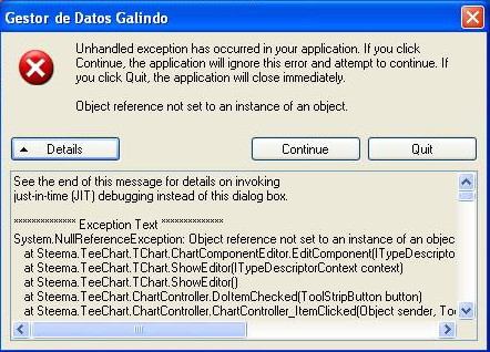

I developed a program which open charteditor, it runs sucessfully in the developer computer, but I installed it in a user computer the chart is seen successfully but when I try to open chart editor it shows this error.
I forgot to add something in the installer?

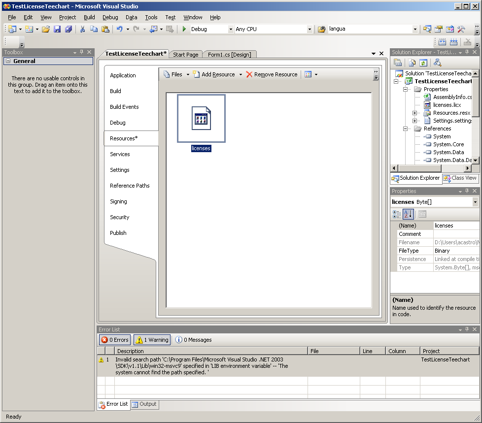

Narcís wrote: licenses.licx should be compiled in your application as an embedded resource. Please check how it is set up in the examples shipped with the installation.
I attached a screenshot, is that the way to add as an embedded resource?

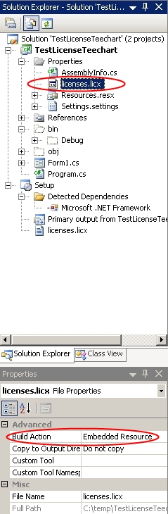

No, it's as shown in the image below, as in the example projects I told you. You already had it correct
