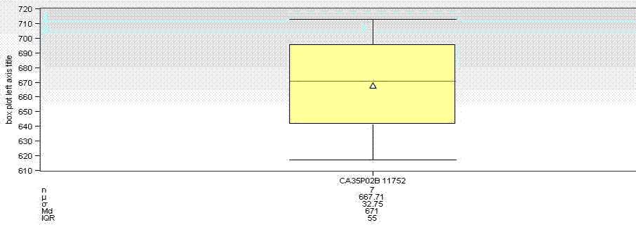

As you could see in the attached image, the box width is changed with the code, but the axis label angel is not changed.

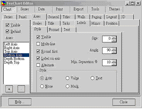

But we could see that the angel is changed to 90 in Chart Editor

Please advise how could we eliminate this issue, thanks
