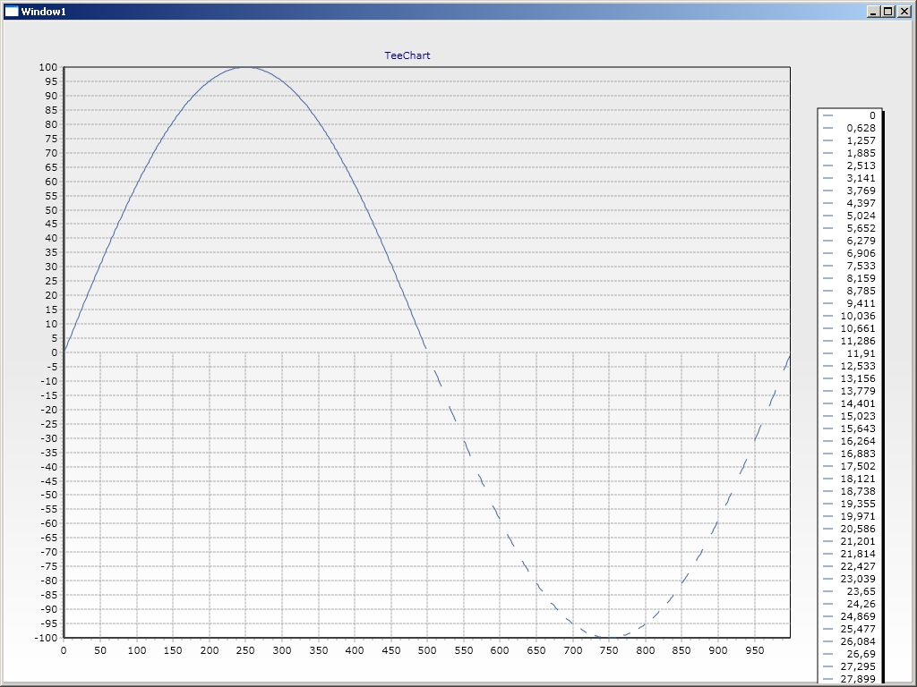

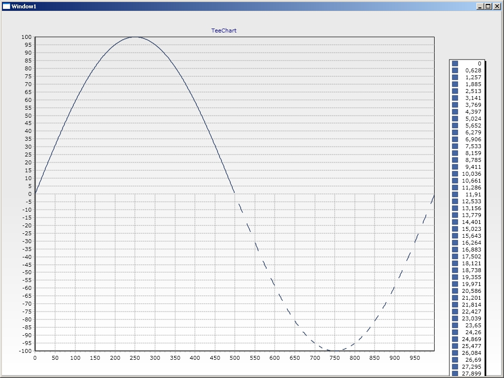

If I understood the problem correctly I think I can't reproduce it here using latest TeeChart for .NET v2009 release which is build 4.0.2009.42281/2/3. Below there are two images 1024*768 I get here using your code. Can you see the differences you speak about with those images? If so, can you please indicate them to us? If not, can you please try if latest build available solves the problem at your end?
FastLine:
Line:

Yes, it looks like this problem is corrected by moving to the most recent version of TeeChart.
