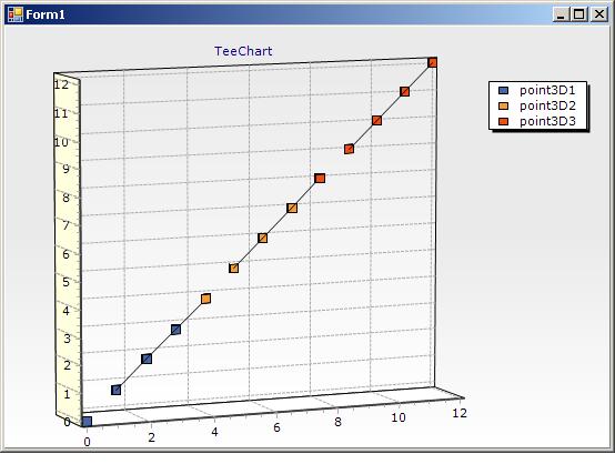

Hello.
Have some problem with chart TeeChartNET2009VSNET2008_4.0.2009.62332.exe
1.Has blank point, when 3D chart is rotated(with rotate tool).(Chart has some series.)
2.Apear new line brom begin point to end point, when rotate 3D chart and used zoom.

Posts: 9676
Re: Wrap chart, when rotate it
Post by Yeray » Tue Mar 23, 2010 3:01 pm
Hi petroV,
Thanks for the code. I could reproduce the problem here so I've added it to the defect list to be fixed in future releases (TF02014744).
