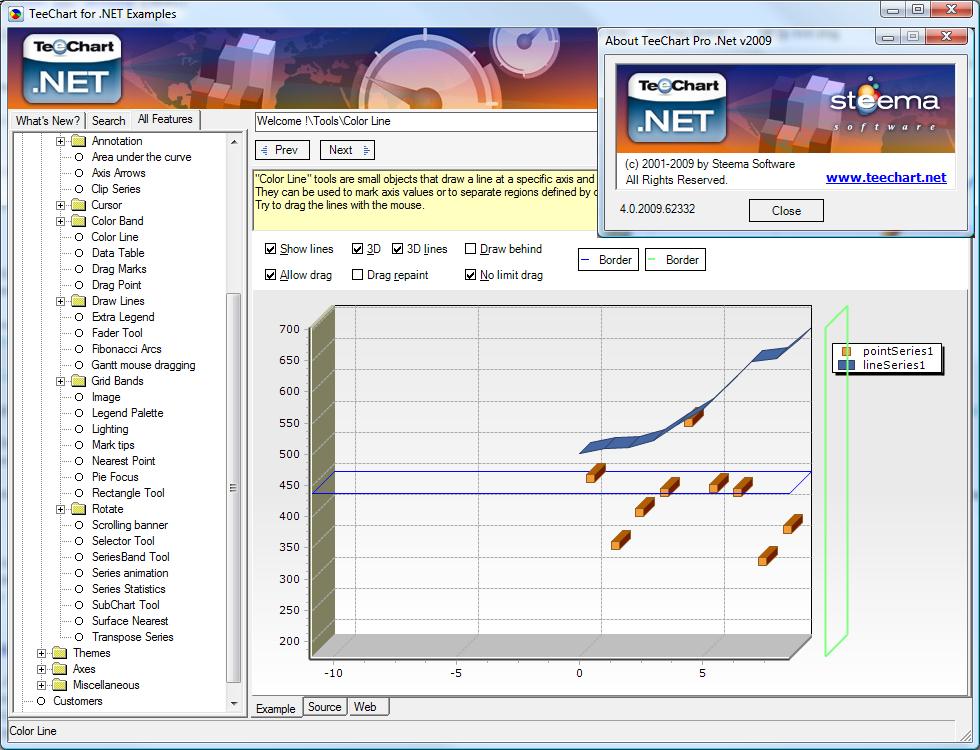

Re: TChart Issues II
re: Color Line issue
see attachment. Note, demo was run under Vista and I think the problem is seen under Windows 7 as well.
Hello Mark,
I understand that when ColorLine is NoLimitDrag=True, and drag it outside the boundaries of chart, it is painted over of Legend. Could you confirm that is it your problem?
Hi Sandra & Narcis,
there is little point in me producing a special project to demonstrate this defect when the TChart demo application can easily demonstrate the problem.
Anyway, I have created a screen capture file BUT it is too big as either .avi or .zip and .camrec is not allowed.
In retrospect, I believe it would possibly have been better use of my time to just fix the TChart problem myself.
Hi Narcis,
I viewed the video and it seems my description of the "ColorLine" problem has not been very clear and I do appreciate that you are sincerely trying to help.
I have uploaded "Demo ColorLine capture.zip".
Hopefully, you will see in my demo that the colorline is NOT moved directly but the chart is panned to the right and then to the left. See my earlier posts for instructions.
