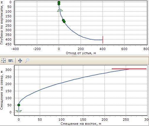

Have bug with GetPointerStyle. I want draw only first points in some series. I have two charts with some series, series on different charts have same DataSource.
Result - first chart draw two first points, second chart don't draw first point in first series.
What do i wrong?

i found proplem - it happen, when Left axe inverted
in attach sample project

I could reproduce your problem, and I think that you didn’t draw first points to series, because your code only works with points of first series:
void line_GetPointerStyle(Steema.TeeChart.Styles.CustomPoint series, Steema.TeeChart.Styles.GetPointerStyleEventArgs e)
      int i = tChart2.Series.IndexOf(series);
      if (i == 0 && e.ValueIndex == index)
        e.Style = Steema.TeeChart.Styles.PointerStyles.Circle;
        e.Style = Steema.TeeChart.Styles.PointerStyles.Nothing;
I modify your code and work correctly with last version of TeeChart .Net. Please, check next code works as you want
Ok, I can reproduce it and I have added in bug Report list with number [TF02014856]. We will try to fix for next versions of TeeChart .Net.
On the other hand, I recommend change property Inverted= true, to Inverted=false, for now.
I hope will helps.
