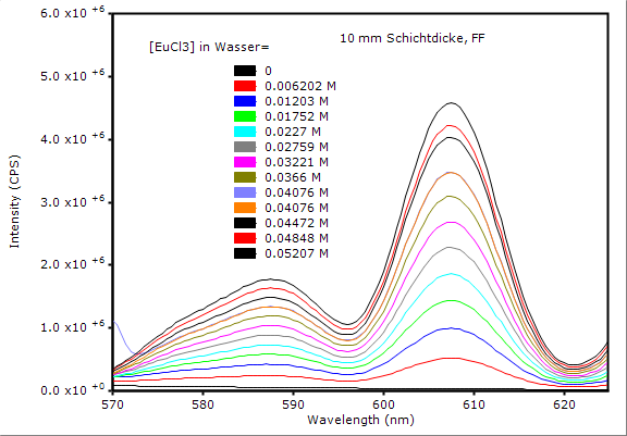

some days ago I installed TeeChart.NET version 2010. Within my main project I still used the TeeChart.dll from 2009 (4.0.2009.62332). Today I added some Dew.Math.TeePro functionality (From DewResearch) which led to a version conflict since Dew.Math.TeePro.dll I built already using the new TeeChart.dll (4.0.2010.13053). I changed the reference to the new dll and rebuild the project (VB). The new dll was really in the bin\debug folder. I noticed nearly immediately, that the symbols in the legend were not drawn correctly (LINE series) when points were set to not visible. Instead of a line a big rectangle was drawn. Making points visible led to correct symbols. (I read a posting about a similar problem with bar charts here and so tried different legend styles - nothing changed)
Illustrates the problem

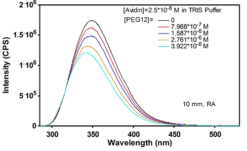

A second topic is related to annotation behavior. Reading and converting old charts (own format) with the TeeChart 2009 I obtained my old text fields now as annotation at the positions according to my old files. With TeccHart 2010 the position is always (0; 0). Why? The corresponding lines:

Re: Line series legend symbol problem
Post by Sandra » Wed May 12, 2010 11:50 am
Hello Uli,
I could found your problem, and I recommend that change property of Legend.Symbol.Width, as next example code:
            tChart1.Legend.Symbol.Width = 15;
Post by Uli » Thu May 13, 2010 6:58 am
Hi Sandra,
thanks for the reply.
I tried it but it does not work. Is there another work around?
Please, you could send us a simple project, because we can reproduce your problem here?
In the zip file (in order to reduce size I deleted TeeChart.dll) you will find the sample project, some remarks:
sample.xyf (the data file created by my old own application, it's relatively large since it contains a preview image)
sample.jpg (image exported from the old application, down sampled with photoshop)
MyLoadXYF.vb (the import module for the old file format. It looks a little bit terrible, since I first checked mschart before I decided to go with TeeChart...)
MyFunctions.vb (some required functions for the import module)
BTW, is there an easy way to include sub / superscript in the axis titles? For scientific applications it's really important.
I know, with importing the text fields from my old application into annotations I loose such format's, too. But when I have the possibility to format the axis titles accordingly I will change the annotations possibly to rich text boxes as shown in your canvas application...
Post by Sandra » Thu May 13, 2010 11:46 am
Hello Uli,
Ok, I have added it in bug report list whit number [TF02014877]. We will try to fix it with next versions of TeeChart .Net.

I recommend that you use event OnDrawSymbol, since when you want treat symbols of legend it’s the correct way to access they. I think you can use similar code as next for solve your problem:
void Symbol_OnSymbolDraw(object sender, Steema.TeeChart.SymbolDrawEventArgs e)
            if (e.Rect.Left==10)
                e.ValueIndex.ToString();
            if (e.ValueIndex == 2)
                if (e.Rect.Top == 2)
                    this.Text = e.ValueIndex.ToString();
That's possibly a misunderstanding. I do not want to treat the legend symbols. What I want is to replace the legend text (series title) by an RTF text with sub and superscripts. So I have to know the rectangle were the normal legend items text would be drawn (I plan to set the font.color to transparent, so I did with the axis title). The problem is that the code related to legend dimensions like
Chart1.Legend.Items(e.Index).SymbolRectangle.Left 'is always(0,0,0,0)
Chart1.Legend.Items(2).Top ' is = 0
does not give any useful value. Why? The code was placed in Chart1_AfterDraw and/or Chart1_GetLegendText events. How can I get the rectangles of the legend items text?
In that case, the only solution I can think of is drawing a custom legend as in the example Christopher Ireland suggested on this thread.

Here you can see an image from my old Delphi application (downsampled with MS Paint, therefore sorry for the quality). There you can see that the multiplication operator on the left axis labels is a "high dot" while it is in the legend a "star". I assume the "high dot" as the more appropriate symbol.
I have made a simple example that I think you can use in your application. Please, see next code and check if it works as you want
            InitializeChart();
        private Steema.TeeChart.Styles.Line line1;
            line1 = new Steema.TeeChart.Styles.Line(tChart1.Chart);
            this.line1.Add(1, 1.0);
            this.line1.Add(2, 1.0e+1);
            this.line1.Add(3, 1.0e+2);
            this.line1.Add(4, 1.0e+3);
            this.line1.Add(5, 1.0e+4);
            this.line1.Add(6, 1.0e+5);
            this.line1.Add(7, 1.0e+6);
            for (int i = 0; i < line1.Count; i++)
                line1[i].Label = "1.0•e+" + Math.Log10(line1[i].Y).ToString();
            tChart1.Axes.Left.Labels.Exponent = true;
            tChart1.Axes.Left.Labels.ValueFormat = "#.0•10 E+0";
            tChart1.GetLegendText += new Steema.TeeChart.GetLegendTextEventHandler(tChart1_GetLegendText);
            tChart1.Axes.Bottom.Labels.Style = Steema.TeeChart.AxisLabelStyle.Value;
        void tChart1_GetLegendText(object sender, Steema.TeeChart.GetLegendTextEventArgs e)
            e.Text = line1[e.Index].Label;
I could reproduce your problem and I have added it in bug report list with number [TF02014922]. We will try to fix it for next maintenance releases of TeeChart .Net.
