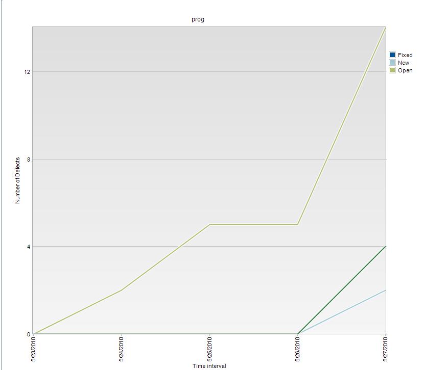

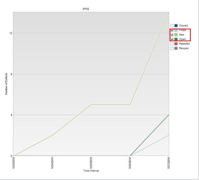

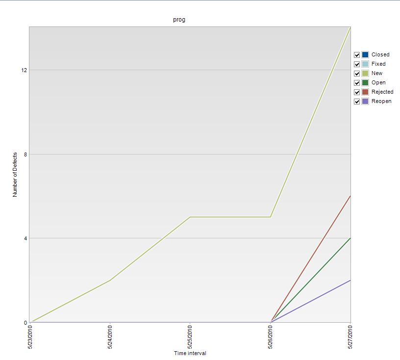

Hi ,
I have a problem -when some of my series are not active and I set the legend CheckBoxes property to be false.
In this case the colors of the legends are wrong.
Steps:
1.This is my chart :
2.I change some of the series to be not active :
3.I chnge the property of the legend to be CheckBoxes = false :
Please advice .

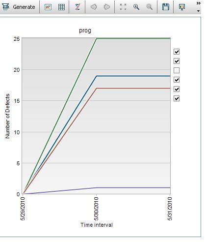

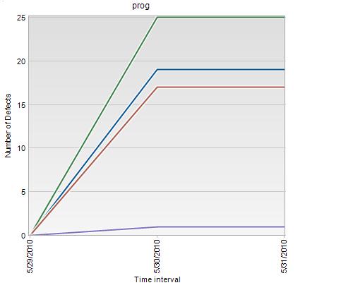

Hi ,
I tried to use the workaround , but it delete the legend and the colors in the chart.
When the checkboxes = true I see :
When the checkboxes = false I see :
I want to see the legend text and the legend color
Please advice.
