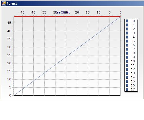

Hello.
Has bug in run and design time.
Add horizontal custom axe and set OTHER SIDE = true and add horizontal line.
In result, labels on custom axe draw in reversed order, but data on line in right order
petroV
Posts: 24
Joined: Tue Mar 02, 2010 12:00 am
Re: problem with horizontal custom axe
Post by petroV » Wed Jun 02, 2010 9:39 am
first point - x = 1010 , y = 0, but on chart, according label on custom axe, first point x ~ 800

wrong code. After creating custom axe1, you assing axe1 with Top axe (axes1 = tChart1.Axes.Top;)
axes1.AxisPen.Color = Color.Red;
line.CustomHorizAxis = axes1;
axes1.OtherSide = true;
need also set
axes1.Horizontal = true;
in real time, don't check what real data in point on chart, if you fill line with rundom data
My problem easy reproduce in design time, step by step:
1. drop Chart
In edit mode chart:
2. add horizontal line
3. add custom axe
4. custom axe set horizontal and otherside
5. and set horizontal line axe - custom axe (Custom 0).

Code for reproduce.
      double x = 0;
      double y = 0;
      Steema.TeeChart.Styles.HorizLine line = new Steema.TeeChart.Styles.HorizLine(tChart1.Chart);
      for (int k = 0; k < 50; k++)
        line.Add(x, y);
        x++; y++;
      Steema.TeeChart.Axis axes1 = new Steema.TeeChart.Axis();
      tChart1.Axes.Custom.Add(axes1);
Post by Sandra » Thu Jun 03, 2010 9:52 am
Hello petroV,
Thanks, for your example, I could reproduce your problem and I have added it in bug report list with number [TF02014929]. We will try to fix it for next maintenance releases for TeeChart.Net. For now, you could use Top axes, so next example:
            double x = 0;
            double y = 0;
                line.Add(x, y);
                x++; y++;
            line.CustomHorizAxis = tChart1.Axes.Top;
            tChart1.Axes.Top.OtherSide = true;
