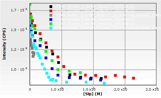

due to the last discovered problem http://www.teechart.net/support/viewtop ... =4&t=11243 concerning wrong axis scaling I immediately checked the new release (Build 4.0.2010.27963, it was published a few minutes after that posting).
This earlier posting is related to a strange axis scaling and therefore I will not add the new problem to this thread. But there you can see how the legend appears with the old release http://www.teechart.net/support/viewtop ... =4&t=11243

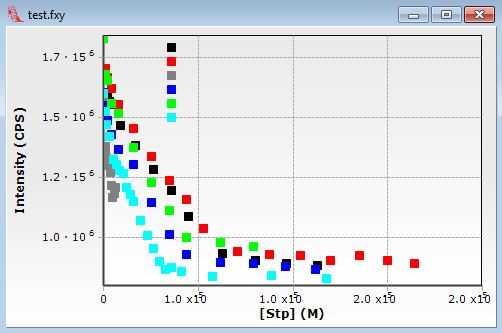

When I now open the same *.ten file (it's contained in the *.zip of the above URL) in my application compiled with the newest release it looks so:
The black legend items text disappeared (the white text is due to another bug explained below)
The reason is:
In order to get sub- and superscripts I go the following way:
- creating custom rich text for legend items
- setting the "regular" legend font to color.transparent but the same size as in my "custom" rich text
- drawing the "custom" legend items in a function called from within the TChart.AfterDraw event using "regular" items properties:
        X = MyChart.Legend.Items(series).Left
        Y = MyChart.Legend.Items(series).Top
And here is the error now: Both X and Y are zero in the application compiled with the new TeeChart release.

And another bug becomes visible (the code in Button1_Click is to follow this): The image above was exported as metafile to clipboard:
ActChildForm.Chart1.Export.Image.Metafile.CopyToClipboard()
and then pasted into MS paint.
You can easily see that the "regular" legends font color (which was set to transparent) is not transparent ***.
This error occurs during metafile export since a screen copy (by means of Windows 7 snipping tool) results in this image:
Here the "regular" legend font seems to be really transparent.

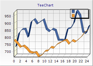

Using previous code I have got next image in .emf format:
teeChart1.zip
(3.29 KiB) Downloaded 1027 times

Post by Uli » Fri Jun 25, 2010 12:05 pm
Hi Sandra,
I tried the code of Christopher with a minimal sample application again. Now it works. I just realized that the first attempt I carried out with my current code under work and I forgot to comment out a following line which copied another empty chart... Sorry! Obviously I was a little bit confused since I tried some other things, too.
I assume this as a workaround with which I can live up to the next maintenance release. But you are still asked to make possible a correct metafile copy via clipboard since the png copy looks not so good when changing the size.
Best regards
Uli
