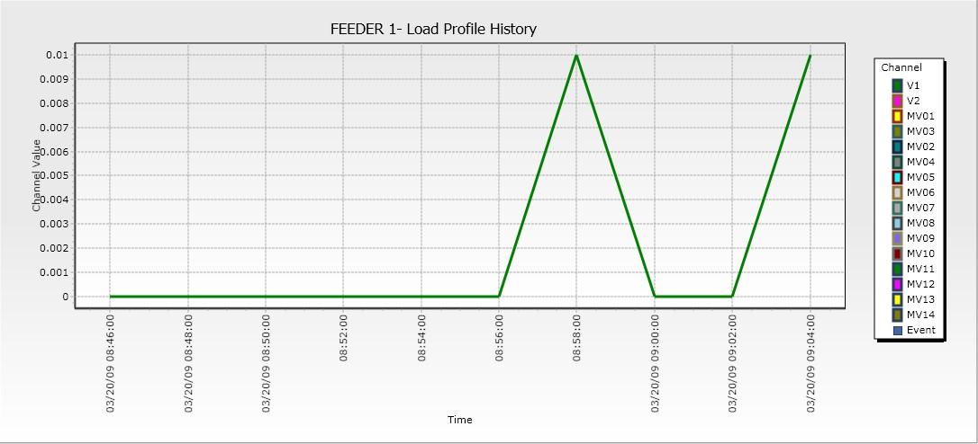

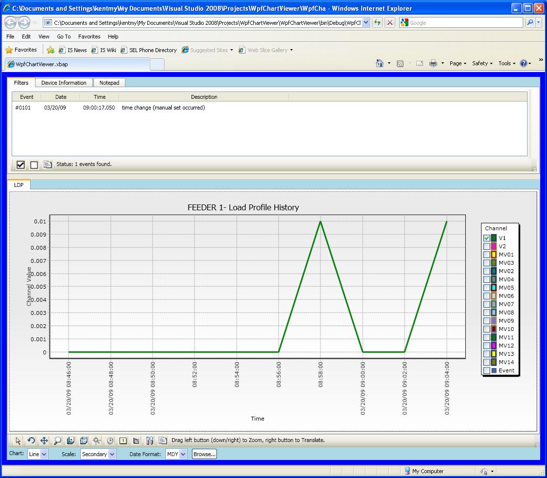

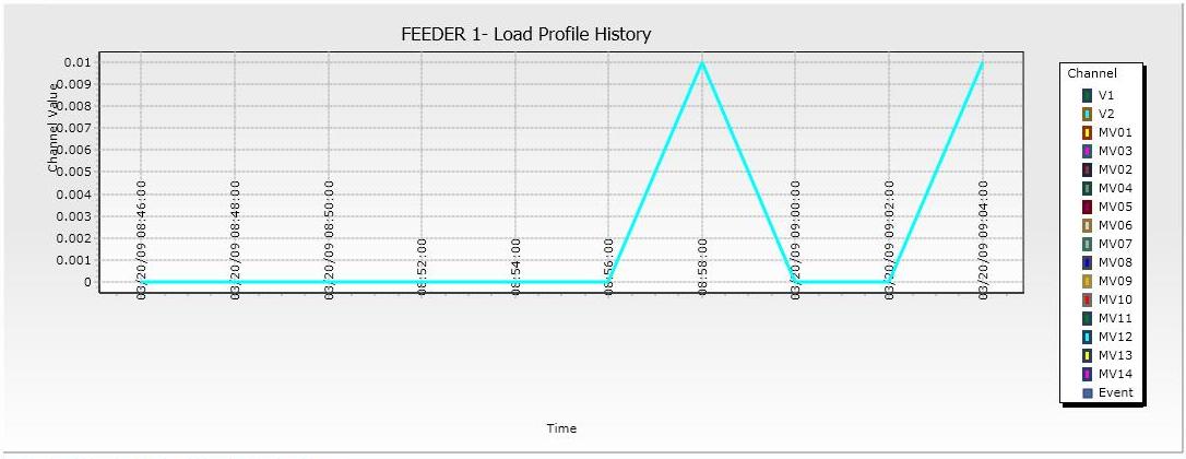

I am porting a WPF Teechart application to Silverlight and found that the WPF positions a rotated bottom axis label correctly, but Silverlight does not (using essentially the same code).
ChartTimeSeries.ChartDisplay.Axes.Bottom.Labels.Angle = 90;
ChartTimeSeries.ChartDisplay.Axes.Bottom.Labels.CustomSize = 110;
Also, the legend checkboxes do not appear in Silverlight, while they do appear in WPF in the native window. The check boxes do not appear when the image is internally copied to the clipboard using the Tchart function ChartDisplay.Export.Image.JPEG.CopyToClipboard()
ChartTimeSeries.ChartDisplay.Legend.CheckBoxes = true;
See attached screen snapshots.
Are these known bugs in the Silverlight Teechart control?

- WPF Legend Check boxes appear in direct screen capture
- WPF2_Axis_labels.JPG (164.37 KiB) Viewed 9306 times
- WPF Legend check boxes do not appear in image capture to clipboard.
- WPF_Axis_labels.JPG (60.02 KiB) Viewed 9287 times
- Silverlight Legend check boxes do not appear and bottom axis labels are incorrectly positioned.
- Silverlight_Axis_labels.JPG (52.7 KiB) Viewed 9286 times

Hello kent,
I could reproduce your problem here and I have added it in Bug report list with number [TW24014995]. We will try to fix it for next maintenance releases of TeeChartSilverlight.I am porting a WPF Teechart application to Silverlight and found that the WPF positions a rotated bottom axis label correctly, but Silverlight does not (using essentially the same code).
Ok, I have added it in Bug report list with number [TW24014996]. We will try to fix it for next maintenance releases of TeeChartSilverlight.Also, the legend checkboxes do not appear in Silverlight, while they do appear in WPF in the native window.
I could reproduce it and I have added it in Bug report list with number [TW16014998].We will try to fix it for next maintenance releases of TeeChartWPF.The check boxes do not appear when the image is internally copied to the clipboard using the Tchart function ChartDisplay.Export.Image.JPEG.CopyToClipboard()
Re: Silverlight Bottom axis rotated label position is incorrect
Hi kent,
I'm afraid we closed the issue with number [TW24014996] removing the checkboxes feature from TeeChart.Silverlight because VisualBrush is missing in silverlight.
