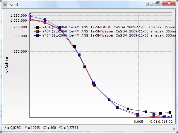

I just realized that the bug is much more engraving: The axis scaling is wrong, the CalcPosPoint method seems to be OK.
So the Logarithmic Scale Bug http://www.teechart.net/support/viewtop ... =4&t=11100 is also present in WinForms, not only in WPF.
The workaround in the above link works BUT:
- it's impossible to get appropriate axis labels (the series x values are between 0* and 0.023)

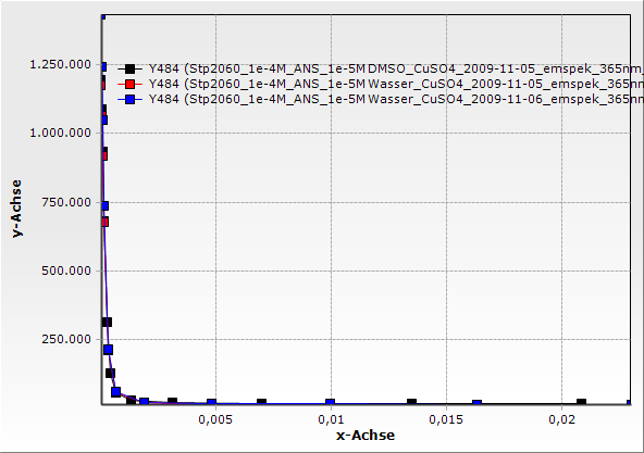

Loading your template file and implementing MouseMove event as you mentioned in this thread, applying the workaorund Yeray suggested and positioning the mouse on the bottom-right corner of the chart I get this:
Is this the same you get? Can you please elaborate on which is the exact problem do you have with this?

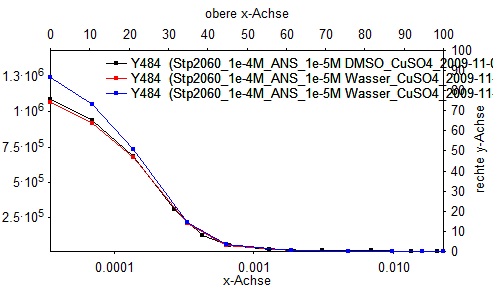

Please look at the chart and you will see that x-Axis labels are not appropriate, they overlap.
I expect an appearance as shown here:
This can be solved changing the bottom axis increment after loading the template file like this:
      tChart1.Axes.Bottom.Increment = 0.01;

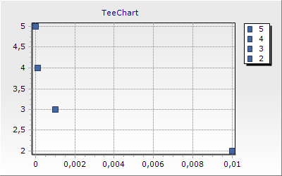

here is the code (Project contains only button, tchart and chart controller). Within this small sample the chart behaves different in comparison to my application but toggling between log and linear scale is still impossible.
    Private Sub Button1_Click(ByVal sender As System.Object, ByVal e As System.EventArgs) Handles Button1.Click
        'TChart1.Import.Template.Load("c:\test2.fxy")
        TChart1.Series.Clear()
        TChart1.Aspect.View3D = False
        '//Workaround suggested at http://www.teechart.net/support/viewtopic.php?f=4&t=11100#p47787
        TChart1.Axes.Bottom.Logarithmic = True
        TChart1.Axes.Bottom.Horizontal = TChart1.Axes.Bottom.Horizontal
        Dim Point As New Steema.TeeChart.Styles.Points(TChart1.Chart)
        For i As Integer = 2 To 5
            Point.Add(Math.Pow(10, -i), i)
        Next
    End Sub

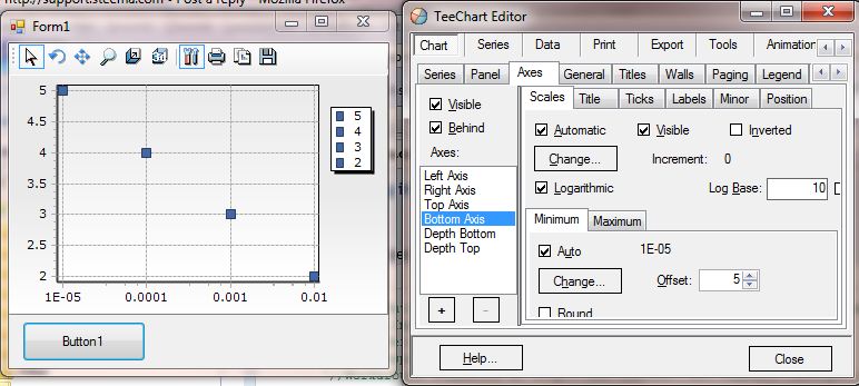

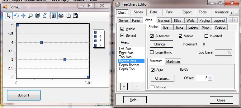

Here you can see the images when toggling the logarithmic property:
It should be very clear that the points must not be at the same positions!
Axis labeling seems to be also dependent from other things. In your mail from 07 Jul 2010 14:57 you got another labeling then I got with this example (x value range is comparable).
Best regards
Uli
Re: Bug in Axis.CalcPosPoint (log scales)
Post by Narcís » Thu Jul 08, 2010 9:42 am
Hi Uli,
This works fine for me here using the sources with the fix for TF02014882 as can be seen here:
This fix will be included in next maintenance release.

Yes, but I can't easily find that. Chart editor has many options and I may miss some property or combination. On the other hand, code gives no option to doubts :wink:. We need to get to the root of the problem to see under which circumstances this occurs and try to find a solution to it. Until we have a consistent way to reproduce the issue we won't be able to search for a solution.
Having said that, I'm trying to create a chart similar to yours from scratch. I exported your data to a XML file, which I attach, and wrote the code snippet below to load it into a clean chart. Code below only loads series with standard settings and its data. Could you please help us modifying the code below to get a chart similar to your problematic one?
OK, I will check it. The problematic file was created with my old application written in Pascal. And, of course, not all properties have an equivalent in TeeChart so something might be gone wrong during conversion. Additionally, I heavily use tags to store experimental parameter or rich text strings.
I have the possibility (it may take some time to figure it out) to only import the data from my old file format. That's comparable to your attempt with the XML file. May be that's another way to come closer to the problem.

You were right, I changed the separators to my settings ("." and space). But by viewing the xml file I noticed that wrong data were in it, correct data you may find in the attached zip. In the original data (and that you can view in the "data" page of the chart editor) only one value has x=0. In your xml file i it seems to be that all data points with x<0.001 were set to x=0.
There is possibly a related phenomenon what I noticed sometimes in the last days nearby: If I set (in the chart editor) the axis increment to a value<0.001 then the axis editor displays "0" after closing the input box. Not sure that it is a general problem since I did not really work with the application (you know, why). Possibly this is related to the things we discuss here.
I did a further test with the synthetic data (see above): When I add a point with x=0 to the series no points were drawn.
When I then toggle between linear/log scale then some points were drawn but still wrong.
In this experiment axis were set to scale automatically. So possibly range checking is wrong: The chart should calculate the axis minimum on the basis of the smallest x > 0. In opposite to that synthetic sample the test2.fxy was imported from my old file format under applying the axis min/max values set in the old data file ("manual" scales). I checked my import class during data import: the axes.bottom.minimum was correctly set to 0.00003xxx. But in the chart editor the axis minimum is displayed as "0". According to the import autoscaling is disabled.
Uli
Post by Narcís » Thu Jul 08, 2010 3:03 pm
Hi Uli,
Thanks for your feedback. I could load your text files into a chart using code below, which produces this chart:
Is this similar to what you are looking for? What do you miss here? Can you try implementing it in the code snippet below?
