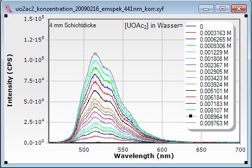

sometimes we have to format or to apply some mathematical operations to individual series. The series (= ActiveSeries in the code above) should be selected by clicking, the selected series should be visualized by the selector tool. The selected series should maintain its status (as selected) until another one becomes selected or the selector will be disposed.
After selecting a series (the selector has been created dynamically by the code in the first message)the following correct image appears:

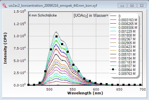

When now clicking somewhere in the chart area but not at a series the following image results:
This seems to be not correct since only series are defined as selectable parts of the selector. Intentionally, the appearance should be the same as in sel1.jpg.
