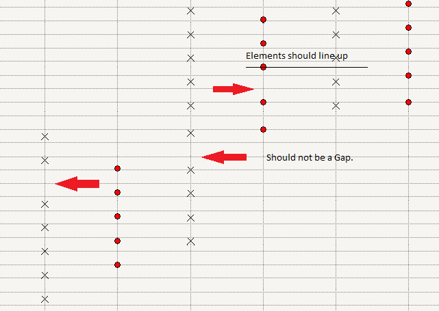

NOW down to business ... please refer to the below image.
Incorrect drawing of a point and figure.
PointFigure Bug.png (12.15 KiB) Viewed 5102 times
This looks like a bug ... in 1) alignment of the boxes (circles and X's) and 2) there are 'gaps' in the stacking.
If this is not actually a bug can you please tell me what settings would effect the Point and figure chart this way.

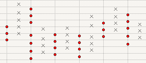

And just in case here's what Point and Figures traditionally look like ...
PointFigure Example.png (5.04 KiB) Viewed 5098 times

Snarkle
Posts: 91
Joined: Wed Jun 30, 2010 12:00 am
Re: Point & Figure - can't populate the series ..
Post by Snarkle » Mon Aug 16, 2010 12:32 am
Not enough data for a series P&F Try this ...
            StockChart.Aspect.View3D = false;
            Steema.TeeChart.Styles.PointFigure series1 = new Steema.TeeChart.Styles.PointFigure(StockChart.Chart);
            //series1.Add(9, 10, 3, 5);
            //series1.Add(9, 8, 5, 6);
            //series1.Add(6, 8, 4, 5);
            series1.FillSampleValues(1000);
            series1.BoxSize = 20;
You'll see the graph render something like this.
Cheers Phil.
Posts: 9562
Post by Yeray » Mon Aug 16, 2010 9:04 am
Hi Phil,
Thanks for the sample. Now I've reproduced it and added to the defect list to be fixed in future releases (TF02015088).
