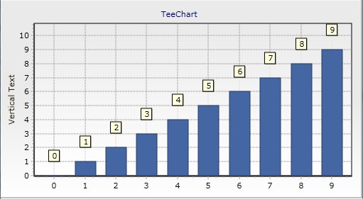

I have problem with export TeeChart with vertical title to xaml format.
For example, if I try to export following instance of TeeChart to xaml

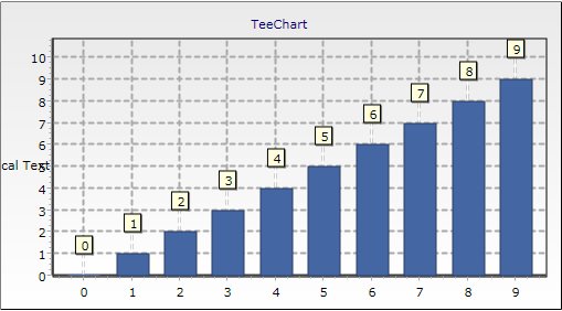

In result I receive xaml, represented at the picture:
The vertical text became horizontal.
Re: Export Vertical Text on the TeeChart to Xaml.
Post by Yeray » Fri Aug 13, 2010 9:38 am
Hi neurosoft,
You are right. It seems that exporting to XAML, the angles in Labels, Marks or Axis Titles are lost. I've added it to the defect list (TF02015086).
