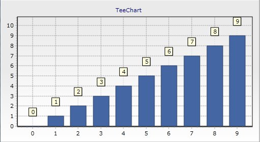

The following code
TChart tChart = new TChart();
tChart.Series.Add(new Bar());
Bar series = tChart[0] as Bar;
tChart.Aspect.View3D = false;
for (int i = 0; i < 10; i++)
    series.Add(i);
series.ShowInLegend = false;
produce the TChart, represented at the picture:

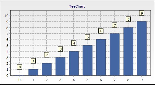

But after the exporting to xaml I receive the incorrect result:
The dashed grid lines is very thick in comparison with the original.

You are right. I've added it to the wish list to be improved in future releases (TF02015132).

The bug was not fixed in the latest release. Please, tell me when I can expect the bug with grid lines (in exported TChart) be fixed. In the next release or later? It is very important for me.

Sorry, but a fix for the enhancement is still pending. I have increase its priority, to be treated soon as possible. On the other hand, I can't still provide an estimate date. I recommend you to be aware at this forum or subscribe to our RSS news feed for new release announcements and what's fixed on them.

This bug is not already fixed. Please, tell me when you can do it?

This bug is fixed in version of the 30 November of TeeChart.Net, concretely in Build 4.1.2010.11303. Please take a look in release notes to check it. On the other hand, if you believe this enhancement isn't implemented or don't work please can you explain, why?
