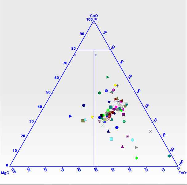

Here is a picture of the ternary plot:
12 ternary charts in the series.
Label font changed to 12 point
Border size changed to 3 pixels
Custom Vertex Labels
Tick Marks Set to True on all axes
Tick Marks only show on left and right axes
Tick Marks do not show on Bottom Axis
Label 0 on right axis vertex does not update to 12 point font
- ternarysteema2.jpg (24.02 KiB) Viewed 16135 times

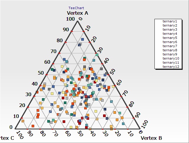

Re: Ternary Tick Marks
Hello lilo,
On the other hand, using next code and last version 4 of TeeChart .Net:
Get below result image:
Could you please, send us a simple project or if you prefer modify my code, because we can reproduce your problem exactly here?
Please see the answer I put in this link12 ternary charts in the series.

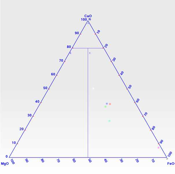

Thanks for your reply,
Here is the result using your code...see picture. Also the bottom tick marks continue not to plot.
TChart1.Series.Chart.Axes.Left.Ticks.Visible = True
TChart1.Series.Chart.Axes.Right.Ticks.Visible = True
TChart1.Series.Chart.Axes.Bottom.Ticks.Visible = True
TChart1.Series.Chart.Axes.Left.Ticks.Length = 7
TChart1.Series.Chart.Axes.Right.Ticks.Length = 7
TChart1.Series.Chart.Axes.Bottom.Ticks.Length = 7
TChart1.Series.Chart.Axes.Left.Ticks.Width = 2
TChart1.Series.Chart.Axes.Right.Ticks.Width = 2
TChart1.Series.Chart.Axes.Bottom.Ticks.Width = 2
TChart1.Series.Chart.Axes.Bottom.Ticks.Color = Drawing.Color.Red
TChart1.Series.Chart.Axes.Left.Ticks.Color = Drawing.Color.Red
TChart1.Series.Chart.Axes.Right.Ticks.Color = Drawing.Color.Red

If i set the pointer = series.Pointer.Brush.Transparency = 0 the line pointers will not plot...star, cross, diagonal cross

If i set the pointer = series.Pointer.Brush.Transparency = 100, none of the pointers will plot correctly...the inner part of the spheres will plot
This is how they should plot with series.Pointer.Brush.Transparency = 0

and this how they should plot with

Hello lilo,
On the other hand,Using next code and last version 4 transparency property works fine for me:
Could you please, tell us if using previous code transparency property works for you? if in previous example doesn't appear your problem, please modify it, because we can reproduce it here.
Steema.TeeChart.TChart tChart1;
this.Controls.Add(tChart1);
InitializeChart();
for (int i = 0; i < 12; i )
new Steema.TeeChart.Styles.Ternary(tChart1.Chart);
tChart1[i].FillSampleValues();
(tChart1[i] as Steema.TeeChart.Styles.Ternary).Pointer.Visible = true;
(tChart1[i] as Steema.TeeChart.Styles.Ternary).Pointer.Brush.Transparency = 0;
