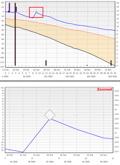

looking through the forums, ive found a reference back in 2007 asking for zooming in the webchart to work for custom axes. it was listed as a soon to be added feature.
at the moment i zoom in on my chart (datetime x axis), and i have 2 custom horizontal axes with different lengths below the default bottom axis
there is no event to capture for zooming in asp.net, so i figured when im checking for the zoomed arraylist, i would adjust each custom axis min and max.
ive come a little stuck with the fact my custom axes are all "different" ranges of values. for example, the default is datetime, the 1st custom is a range of 0-x days, and the 2nd custom is a range of degrees...
how can i get the max and min of the zoom rectangle for these custom axes...
or is there a teechart implementation i can use that ive been unable to find in the help documentation.

not quite what i was looking for.
ive come up with a poor solution... but should suffice until the feature is added (though the feature wont make back into 3.5, so id have to upgrade). i should note that i still doesnt work exactly as needed, but im working on it.
attached is a picture of the scenario i was attempting to describe.
notice that the GDD axis doesnt match up.
if you have a further solution, let me know...
