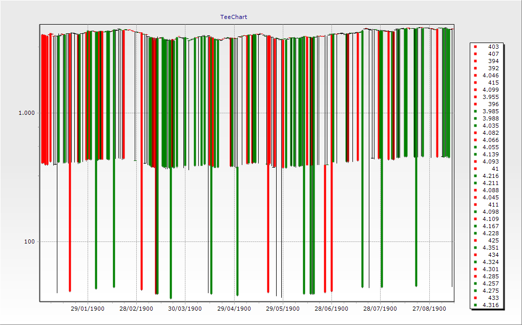

Hi Sandra,
Your screen shots are different to what my chart displays, especially the scaling on the non log screen shot. I have posted screen shots of what my chart looks like in non log and log. The version of TeeChart used for the sample applicaiton is 4.1.2010.11301.
- Log
- Log.jpg (146.26 KiB) Viewed 8983 times
- Non Log
- No Log.jpg (146.26 KiB) Viewed 8984 times
Cheers Phil.
Cheers Phil.

Hi Phil,
Sorry, my bad. Now I have found which was the difference between your project and hours. I had to set my regional settings to English (US) to get the same as you get. I guess my settings (Catalan) were interpreting decimal and thousand separators in a different way. I think the problem is that no logarithmic labels as your data goes from 35.5 to 46.5 approximately. This means they don't fall into a range that a logarithmic label (1, 10, 100, 1000, etc.) label is displayed. I modified your code a little bit to modify left axis minimum and maximum values when it's logarithmic so that labels are displayed:
Another alternative would be using custom labels. You can find an example at All Features\Welcome !\Axes\Labels\Custom labels in the features demo, available at TeeChart's program group.
if (SemiLogActive == false)
tChart1.Axes.Right.Logarithmic = true;
tChart1.Axes.Left.LogarithmicBase = 10;
tChart1.Axes.Right.LogarithmicBase = 10;
tChart1.Axes.Left.SetMinMax(10, 100);
tChart1.Refresh();
SemiLogActive = true;
button1.Text = "Turn Off Semi Log";
GetScreenShot("Log.png");
tChart1.Axes.Left.Logarithmic = false;
tChart1.Axes.Right.Logarithmic = false;
tChart1.Axes.Left.Automatic = true;
tChart1.Refresh();
button1.Text = "Turn On Semi Log";
SemiLogActive = false;
GetScreenShot("NoLog.png");
