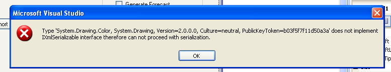

Using tChart .Net v3 I get the error below:
Type 'System.Drawing.Color, System.Drawing, Version=2.0.0.0, Culture=neutral, PublicKeyToken=b03f5f7f11d50a3a' does not implement IXmlSerializable interface therefore can not proceed with serialization.
Whever I edit the chart and then try and save the form it lives on.

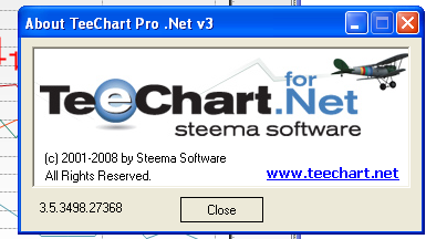

see attached image for error and chart version.
Could this be a .Net version problem?
