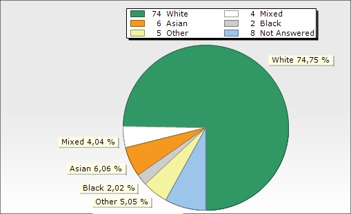

2 Questions on the pie charge sample attached,
1. how can I add the % symbol next to the figure
My code is:-
pie.Add(Convert.ToInt32(ethnicperc1), "White", Color.FromArgb(49, 151, 101));
pie.Add(Convert.ToInt32(ethnicperc2), "Mixed", Color.FromArgb(255, 255, 255));
pie.Add(Convert.ToInt32(ethnicperc3), "Asian", Color.FromArgb(245, 152, 31));
pie.Add(Convert.ToInt32(ethnicperc4), "Black", Color.FromArgb(205, 205, 205));
pie.Add(Convert.ToInt32(ethnicperc5), "Other" , Color.FromArgb(244, 243, 160));
pie.Add(Convert.ToInt32(ethnicperc6), "Not Answered", Color.FromArgb(157, 197, 233));
pie.Rotate(90);
2. The pie appears to be generated anticlockwise, is there a way of make it clockwise

Re: Pie Charts
Hello MikeTheLad,
For example:
I hope will helps.
You need use property Style of Marks as do in next simple code:1. how can I add the % symbol next to the figure
Steema.TeeChart.Styles.Pie pie = new Steema.TeeChart.Styles.Pie(tChart1.Chart);
tChart1.Legend.Visible = true;
tChart1.Header.Text = "";
pie.Circled = true;
tChart1.Chart.Panel.Color = System.Drawing.Color.White;
tChart1.Chart.Panel.Bevel.Outer = Steema.TeeChart.Drawing.BevelStyles.None;
tChart1.Chart.Panel.Bevel.Inner = Steema.TeeChart.Drawing.BevelStyles.None;
Random rnd = new Random();
int ethnicperc1, ethnicperc2, ethnicperc3, ethnicperc4, ethnicperc5, ethnicperc6;
ethnicperc1 = 74;
ethnicperc2 = 4;
ethnicperc3 = 6;
ethnicperc4 = 2;
ethnicperc5 = 5;
ethnicperc6 = 8;
pie.Marks.Style = MarksStyles.LabelPercent;
pie.CustomXRadius = 120;
pie.CustomYRadius = 120;
pie.Add(ethnicperc1, "White", Color.FromArgb(49, 151, 101));
pie.Add(ethnicperc2, "Mixed", Color.FromArgb(255, 255, 255));
pie.Add(ethnicperc3, "Asian", Color.FromArgb(245, 152, 31));
pie.Add(ethnicperc4, "Black", Color.FromArgb(205, 205, 205));
pie.Add(ethnicperc5, "Other", Color.FromArgb(244, 243, 160));
pie.Add(ethnicperc6, "Not Answered", Color.FromArgb(157, 197, 233));
pie.Rotate(180);
I recommend you change the angle of rotation to achieve make the pie as clockwise.2. The pie appears to be generated anticlockwise, is there a way of make it clockwise
For example:
pie.Rotate(180);

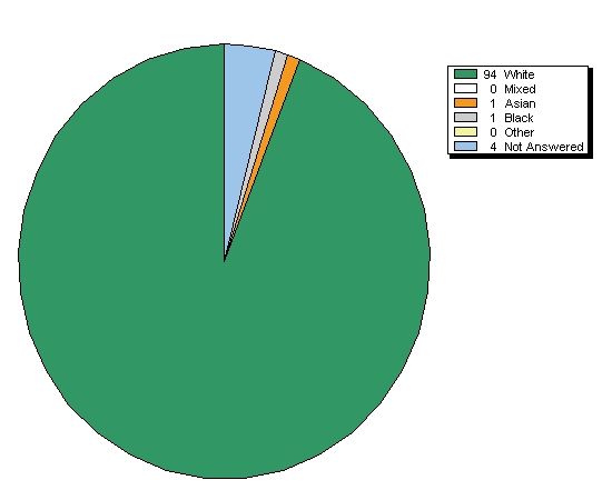

I have created in Phtoshop what I require the pie to look like

Re: Pie Charts
Hello MikeTheLad,
Ok. Seems finally I have understood you want achieve. I have made a simple code where used an auxiliary pie series to save the originaly values and other series to manipulate values. Please see next code and check if works as you want:
I hope will helps.
Steema.TeeChart.Styles.Pie pie1, pieaux;
tChart2.Aspect.View3D = false;
pieaux = new Steema.TeeChart.Styles.Pie();
pie1 = new Steema.TeeChart.Styles.Pie(tChart2.Chart);
tChart2.Header.Text = "";
tChart2.Chart.Panel.Color = System.Drawing.Color.White;
tChart2.Chart.Panel.Bevel.Outer = Steema.TeeChart.Drawing.BevelStyles.None;
tChart2.Chart.Panel.Bevel.Inner = Steema.TeeChart.Drawing.BevelStyles.None;
ethnicperc1 = 94;
ethnicperc2 = 0;
ethnicperc3 = 1;
ethnicperc4 = 1;
ethnicperc5 = 0;
ethnicperc6 = 4;
// Save Originaly values.
pieaux.Add(ethnicperc1, "White", Color.FromArgb(49, 151, 101));
pieaux.Add(ethnicperc2, "Mixted", Color.FromArgb(255, 255, 255));//white
pieaux.Add(ethnicperc3, "Asian", Color.FromArgb(245, 152, 31));//Orange
pieaux.Add(ethnicperc4, "Black", Color.FromArgb(205, 205, 205));//Grey
pieaux.Add(ethnicperc5, "Other", Color.FromArgb(244, 243, 160));//Yellow
pieaux.Add(ethnicperc6, "Not Answered", Color.FromArgb(157, 197, 233));//blue skye
//Add values
pie1.Add(pieaux.YValues[5], pieaux.Labels[5], pieaux.Colors[5]);
pie1.Add(pieaux.YValues[4], pieaux.Labels[4], pieaux.Colors[4]);
pie1.Add(pieaux.YValues[3], pieaux.Labels[3], pieaux.Colors[3]);
pie1.Add(pieaux.YValues[2], pieaux.Labels[2], pieaux.Colors[2]);
pie1.Add(pieaux.YValues[1], pieaux.Labels[1], pieaux.Colors[1]);
pie1.Add(pieaux.YValues[0], pieaux.Labels[0], pieaux.Colors[0]);
pie1.Rotate(90);
tChart2.Legend.Inverted = true;
pie1.Marks.Visible = false;
pie1.Marks.Pen.Visible = false;
pie1.Marks.Arrow.Visible = false;
pie1.Circled = true;
pie1.Marks.Style = MarksStyles.LabelPercent;
pie1.CustomXRadius = 120;
pie1.CustomYRadius = 120;
tChart2.Panel.MarginRight = 20;

Re: Pie Charts
Thank you, that worked, any ideas how I can do the % symbol in the legend, ie
94% white
0% Mixed
1% Asian
etc
If I try to add the % in the following line it fails to build
ie
pie.Add(Convert.ToInt32(ethnicperc1) & "%", "White", Color.FromArgb(49, 151, 101)); This fails
94% white
0% Mixed
1% Asian
etc
ie
Re: Pie Charts
Hello MikeTheLad,
You only need change TextStyle of Lenged as do in following line of code:
I hope will helps.
tChart2.Legend.TextStyle = Steema.TeeChart.LegendTextStyles.LeftPercent;
I hope will helps.

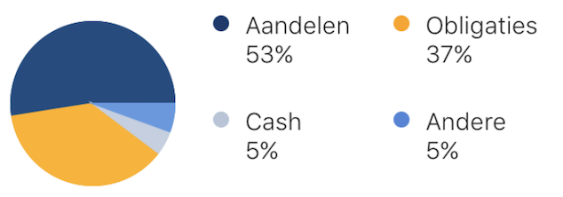

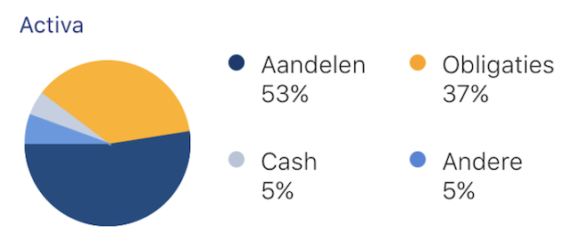

Re: Pie Charts
What is the actual part for triggering that pie data is filled up clockwise instead of default counterclockwise?
Tried playing with RotationAngle without any luck.

- Newbie
- Posts: 22
- Joined: Tue Aug 08, 2017 12:00 am
Re: Pie Charts
Like I said, I'm still clearly missing the actual correct code?
So image 1 is regular pie chart, you notice that first value ( dark blue ) is followed by orange rotated counterclockwise.
Second image is same pie with the rotate 180. So now all values are flipped over horizontal axes of the pie, but still fill up counterclockwise...
Any other ideas I can test?
