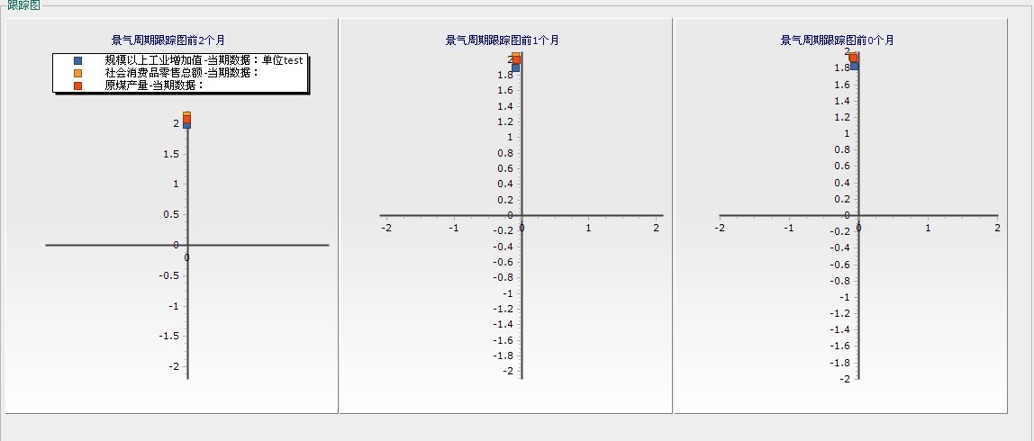

My aim is to present several coordinate system sharing the same legends.
Following are the charts I've got, in which I drew 3 coordinate systems in 3 TChart Objects. They share the same legensd which I added to the first chart. They appear ugly now. If added the legends to every chart, it's space consuming. To polish my charts, can I draw more than one coordinate systems in a chart? Or, can I draw a chart with legend but not any coordinate system?
I've tried myself, and search the forum for answers without result. Does any one has any idea? I'll be appreciated.

Hi Helen,
Yes, you can use SubChart tool hiding each chart legend except for the parent chart. You'll find SubChart examples at All Features\Welcome !\Tools\SubChart Tool in the features demo available at TeeChart's program group. Alternatively you can also do something as in the All Features\Welcome !\Chart styles\Standard\Pie\Multiple Pies example.
I'm afraid not.
Hope this helps!

Problem solved using SubChart, thanks very much.
