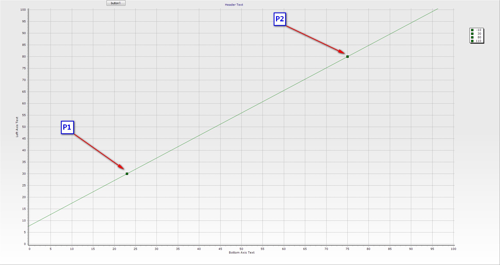

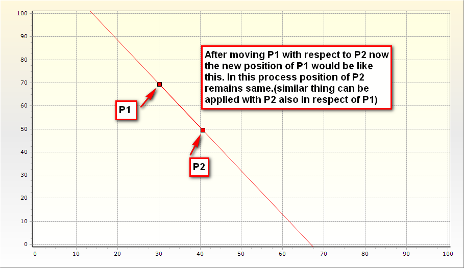

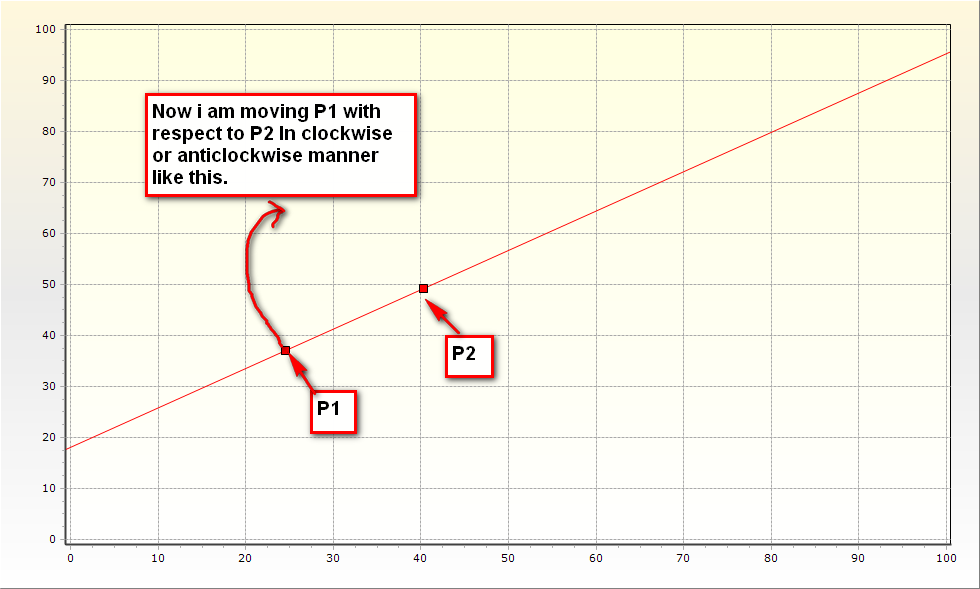

Hi Steema Support,
We are creating a line chart which have two points P1 and P2. Now we extend this line so that it touch boundaries of chart by adding two more point at first index and last index respectively. Means there is now total four points on line:
P0-> which is first point of line series and touches bottom boundary (not visible as this point is out of boundary)
P1-> which is second point of line series and always displayed on chart.
P2-> which is third point of line series and always displayed on chart.
P3-> which is last point of line series and touches top boundary. (not visible as this point is out of boundary)
However we more concerned with P1 and P2.

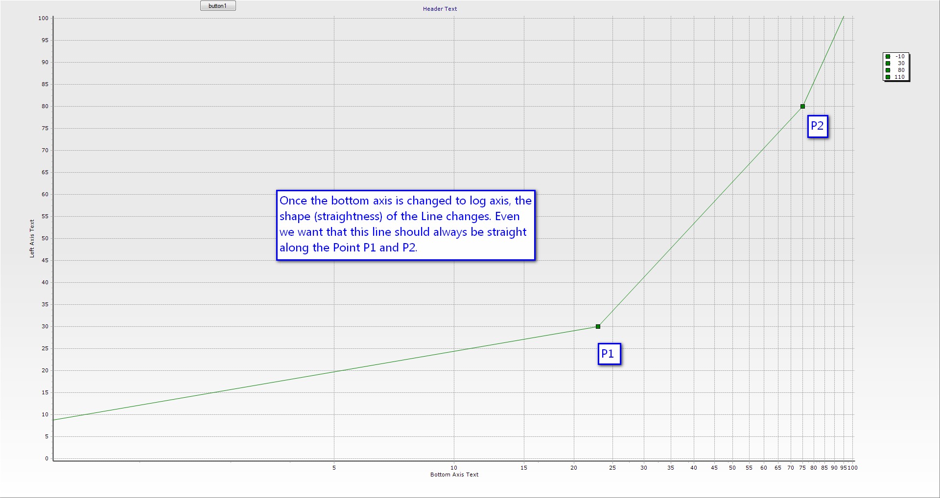

Now the problem is, once we change the bottom axis to Logarithmic axis line does not remains straight.
Our objective is the line should always be straight along with P1 and P2 point.
We are also attaching our project for more help.
Please suggest if we are doing something wrong. Any suggestion will be highly appreciated.

The link you provided is not fruitful for us because we have a line which has Two Points P1 & P2 and from this Point we want to draw a straight line And Line must be moved with respect to P2 point if we move P1 Point and vice versa also . I have tried the movement of one point of line with resprct to another point in linear axes and I am getting success in it. Now I have tried same logic where Bottom axes of chart is set to Logarithmic now I am unable to achieve this objective. I am attaching code for Linear Axes.
Please help us to achieve the same objective in Logarithmic axes as soon as possible I will be very thankful to you
