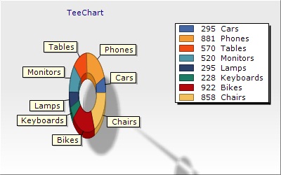

Shadow -> Smooth is totally broken for every object that can have a shadow
Thanks for reporting. I could reproduce the issue here and added it (TF02016115) to the bug list to be fixed.
but the real piece of art is smooth shadow (make offsets big enough to see it) on a Donut series!
Using this code snippet:
      Steema.TeeChart.Styles.Donut donut1 = new Steema.TeeChart.Styles.Donut(tChart1.Chart);
      donut1.FillSampleValues();
      donut1.Shadow.Visible = true;
      donut1.Shadow.Smooth = true;
I got this image:
I added the issue (TF02016116) to the bug list to be investigated. Is this the same you got at your end?
