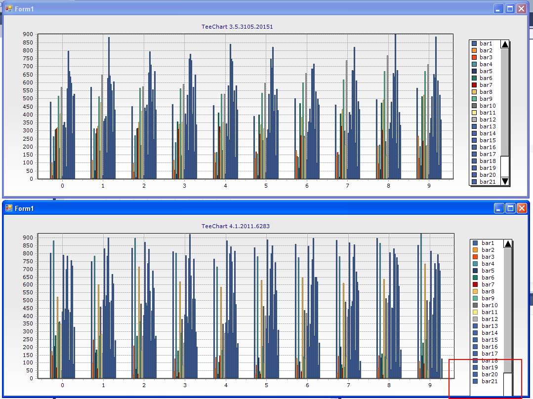

till last week we used TeeChart 3.5 (3.5.3105.20151) for over 4 years now but finally we upgraded to version 4.1 (4.1.2011.6283). In one of my first tests i found an issue with the LegendScrollBar tool. The size of the legend does not fit anymore and i have not found a usefull way to fix the problem for my own. In the attachment you can find an illustration of what i mean.
I used the following code for each TeeChart version:

The issue occure if you resize the form. The initially size of the legend is correct but after resizing it is wrong.
Did you have a fix or a workaround for this behaviour?

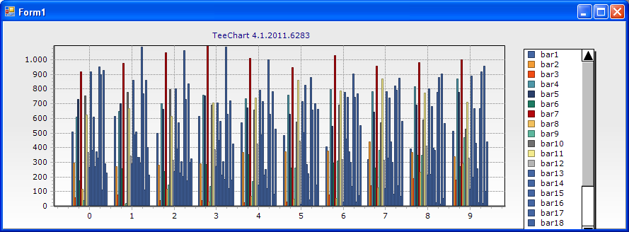

No, your code does not work. Setting a fixed width but don't know how much space the labels realy require is not a good solution. In my real world progam i have 1 to 100 possible legend entries each with different text lenghts. I do not know how much space is required and is available (scrollbar). Why does the "AutoSize" does not work anymore? Before it satisfy all needs.
I attached the results of your code as screenshots.
Thanks for your help.

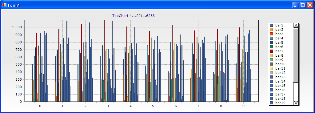

Initial after start
After resizing (made it smaller)
