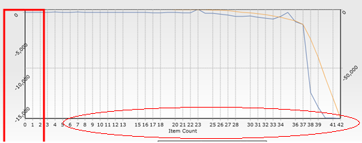

I'm using Steema Silverlight version. I'm displaying a curve for each consecutive number on Bottom Axis. I've set
increment property of bottom Axis to 1 by using the following statment.
TeeChart.Axes.Bottom.Increment = 1;
But this is not working when number of values are large. Plz refer the attached screenshot. notice the gap between
13 & 15
18 & 20
23 & 25
28 & 30
Bottom Axis values.PNG (42.44 KiB) Viewed 8564 times

Hello Neelam,
I suggest use next code where I am using custom labels to draw all values:
Steema.TeeChart.Silverlight.Style.Line Series1;
            Series1 = new Steema.TeeChart.Silverlight.Styles.Line(tChart1.Chart);
            Random rnd = new Random();
            for (int i = 0; i < 40; i++)
                Series1.Add(i, rnd.Next(10000));
            tChart1.Axes.Bottom.Labels.Style = AxisLabelStyle.PointValue;
            AddLabels();
        private void AddLabels()
            for(int i=0; i< Series1.Count;i++)
                tChart1.Axes.Bottom.Labels.Items.Add(i, i.ToString());
Can you tell us if previous code solve your problem?
