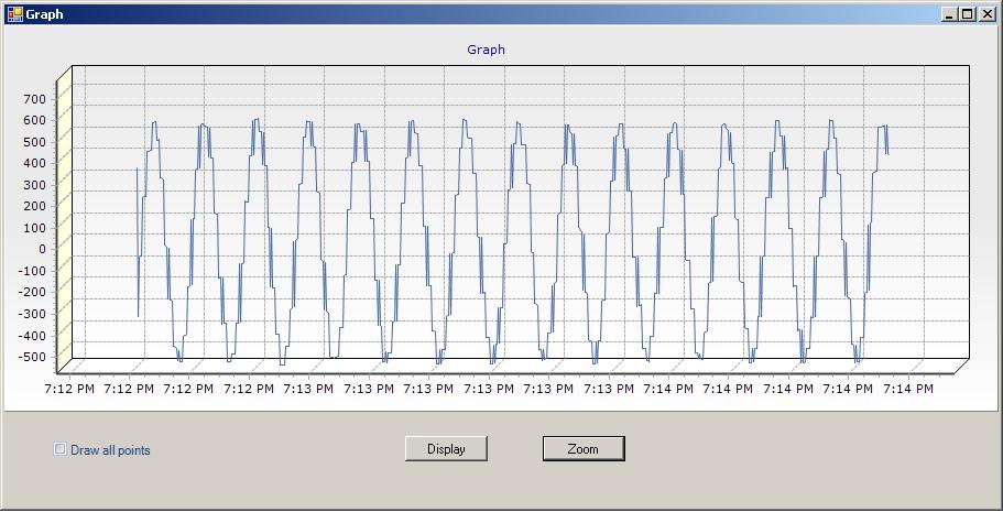

We are using Fastline series and having weired issues with zooming when DrawAllPoints is set to false. When the graph is initially drawn with DrawAllPoints=False, with about 18000 plus data points, the display look nice and smooth with good curve fitting. However, when we either increase the tchart's width or use mouse based selection zoom, the display changed to some unexpected pattern. When DrawAllPoints = true is set, the display looks cluttered, but has predictable clarity when zoomed or tchart's width is increased.
Please see the attached doc file for screenshots. This is a serious issue for us and like to know if there is a solution.

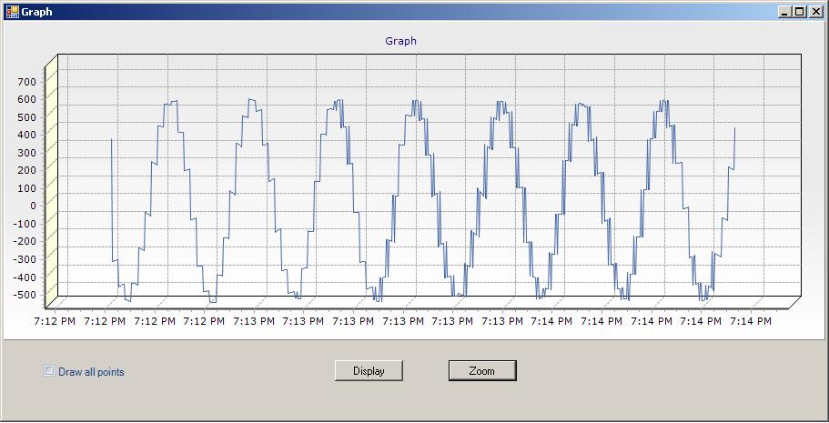

As stated and showed in my first post in this thread, the issue is that when we have DrawAllPoints=false, the graph display trend we get changes drastically with width of the chart.
For example, see the following images:
Please note that the 'Zoom' functionality simply increases the width of the graph panel and is not really a zoom in T-Chart's sense.
The initial display looks as follows: After 4-5 clicks on the 'Zoom' button, the trend changes as follows: After about 12 clicks on the 'Zoom' it changes as follows:

As is shown in the posted image above messagehttp://www.teechart.net/support/posting ... 08#pr57399, the zoomed image shows stepped connecting line between the points when DrawAllPoints is set to true. The sample attached in this thread above is a good one to reproduce the problem (with DrawAllPoints set to true) when you zoom close enough to see each waveform.
What we need is a way to smooth these stepped lines such that we provide a smooth curve fitting at every zoom level.

Here is what we decided and like to see if TChart can help us with this.
