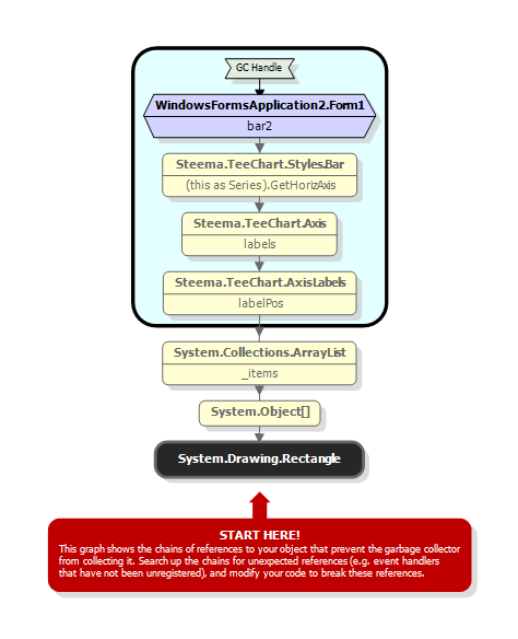

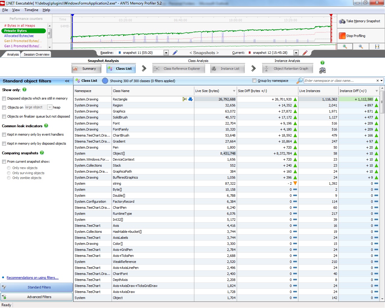

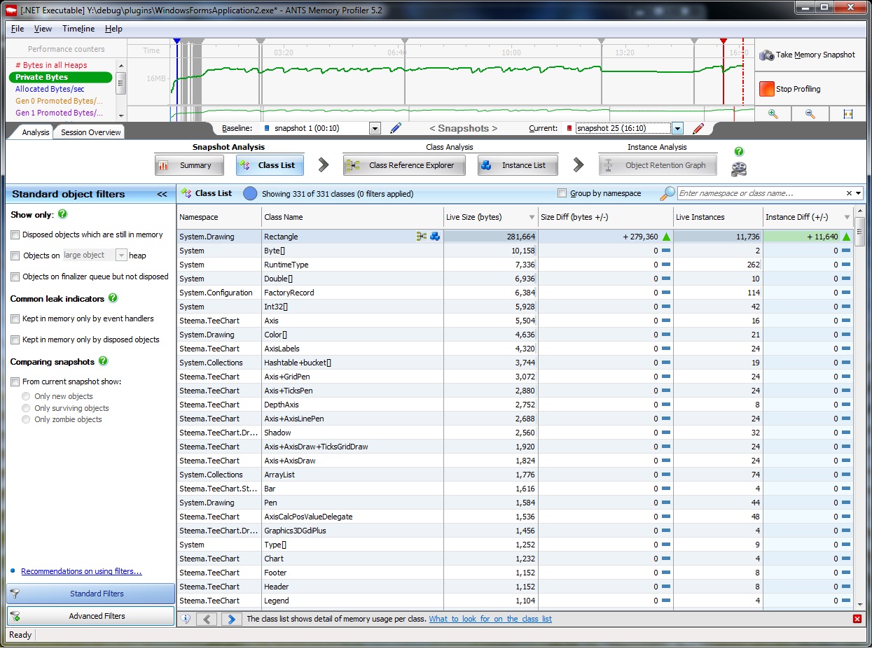

I am experiecing significant memory creep when updating bar values on a bar series. Running memory profile shows large amounts of Rectangles been created from the bottom AxisLabels. Reproducible on TeeChart .Net v2 and latest TeeChart .Net 2012

Attached is sample project with the issue and screenshots of the memory profiler.
