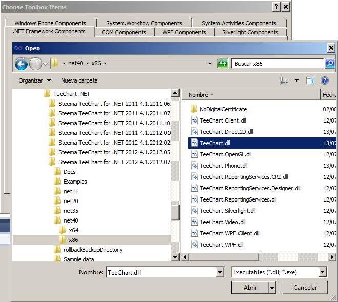

If the installer failed when trying to install the component in the Visual Studio Toolbox, you can always do it manually creating a new tab in the toolbox and browsing to the dll through the "Choose Items..." option.

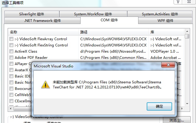

but I according your suggestion."you can always do it manually creating a new tab in the toolbox and browsing to the dll through the "Choose Items..." , at the dir. of "C:\Program Files (x86)\Steema Software\Steema TeeChart for .NET 2012 4.1.2012.07130\net40\x64", the os is Win7 x64. I select the TeeChart.dll, press ok buttion. there is wrong message. "Could not load the class lib C:\Program Files (x86)\Steema Software\Steema TeeChart for .NET 2012 4.1.2012.07130\net40\x86\TeeChart.tlb". then I select the file TeeCahrt.dll at C:\Program Files (x86)\Steema Software\Steema TeeChart for .NET 2012 4.1.2012.07130\net40\x86, the same message appears.

The 64bit version of the TeeChart.dll doesn't support design time. You have to add the 32bit version of the TeeChart.dll (C:\Program Files (x86)\Steema Software\Steema TeeChart for .NET 2012 4.1.2012.07130\net40\x86).sunzhaoshan wrote:but I according your suggestion."you can always do it manually creating a new tab in the toolbox and browsing to the dll through the "Choose Items..." , at the dir. of "C:\Program Files (x86)\Steema Software\Steema TeeChart for .NET 2012 4.1.2012.07130\net40\x64", the os is Win7 x64. I select the TeeChart.dll, press ok buttion. there is wrong message. "Could not load the class lib C:\Program Files (x86)\Steema Software\Steema TeeChart for .NET 2012 4.1.2012.07130\net40\x86\TeeChart.tlb".
If you selected the TeeChart.dll from the x64 folder, I don't understand how it can be warning you about a TeeChart.tlb from the x86 folder. Was it a mistake? A double mistake?
This should work. It does for me here:sunzhaoshan wrote:then I select the file TeeCahrt.dll at C:\Program Files (x86)\Steema Software\Steema TeeChart for .NET 2012 4.1.2012.07130\net40\x86, the same message appears.

The wrong message is as following pic.
- the wrong message

It might be that the installer or the files copied were corrupted. Could you please try downloading and installing the installer again? If the problem persists, could you please translate into English the text of the error message?

The vision of TeeChart which I installed was TeeChartNET2012_4.1.2012.07130.exe, according to your suggestion, I uninstalled it ,then installed the same vision, but it failed. then I try to install TeeChartNET2012_4.1.2012.05100.exe, It's successed.

Ok, if you want to install the newer version please try downloading it again and let us know the error message again if you get any.The vision of TeeChart which I installed was TeeChartNET2012_4.1.2012.07130.exe, according to your suggestion, I uninstalled it ,then installed the same vision, but it failed. then I try to install TeeChartNET2012_4.1.2012.05100.exe, It's successed.
