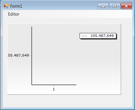

I want to show a very small chart (size 400 x 300). When I add only one data point with a float value on the Y Axis, this float value gets trimmed on the left side.
From the moment that I add a second data point, the values are shown correctly.
Why is this value trimmed when I have only one data point?

You can see the result in the attached screenshot.

I suggest you do something as next code to achieve your code works as you expect:
    Steema.TeeChart.Styles.Line line;
            this.Width = 500;
            this.Height = 400;
            tChart1.Height = 300;
            tChart1.Width = 400;
            line = new Steema.TeeChart.Styles.Line(tChart1.Chart);
            line.Add(1, 105487.648984894);
            tChart1.Draw();
            tChart1.Panel.MarginUnits = PanelMarginUnits.Pixels;
            tChart1.Panel.MarginLeft = tChart1.Panel.MarginLeft + tChart1.Axes.Left.MaxLabelsWidth();
            tChart1.ShowEditor();
Can you tell us if previous code works as you want?
I hope will helps.

Your solution solved my problem.
