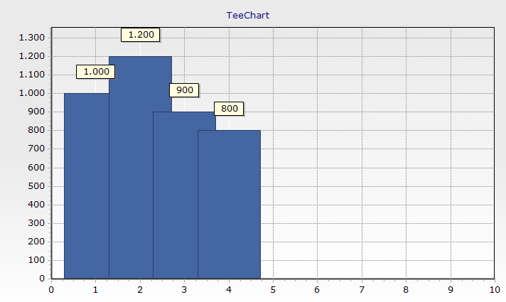

When I set the min and max values of my bottom axis, my bars start to overlap as shown in the screenshot attached.
The code I use is the following:
chartToTest.Aspect.View3D = false;
chartToTest.Axes.Bottom.Automatic = false;
chartToTest.Axes.Bottom.Minimum = 0;
chartToTest.Axes.Bottom.Maximum = 10;
Steema.TeeChart.Styles.Bar bar = new Steema.TeeChart.Styles.Bar(chartToTest.Chart);
bar.Add(1, 1000);
bar.Add(2, 1200);
bar.Add(3, 900);
bar.Add(4, 800);
What can I do to make the bars fit next to each other.

We have considered your problem as a feature request with number [TF02016328] to be consider its inclusion in upcoming versions of TeeChartFor.Net. At the moment, a workaround to solve the problem you can change the BarWidthPercent to resize the bars. You can do something as next:
            tChart1.Axes.Bottom.Automatic = false;
            tChart1.Axes.Bottom.Minimum = 0;
            tChart1.Axes.Bottom.Maximum = 10;
            Steema.TeeChart.Styles.Bar bar = new Steema.TeeChart.Styles.Bar(tChart1.Chart);
            bar.Add(1, 1000);
            bar.Add(2, 1200);
            bar.Add(3, 900);
            bar.Add(4, 800);
            bar.BarWidthPercent = 25;
I hope will helps.

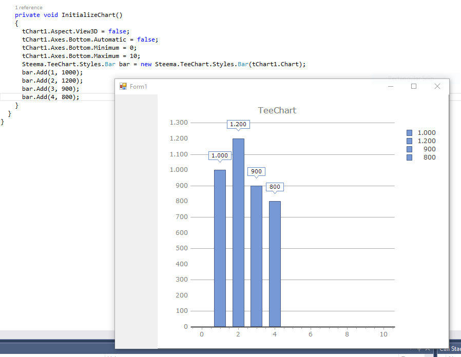

Re: Bars overlap
Post by Christopher » Thu Jan 26, 2017 2:42 pm
PidoTech wrote:Is this issue fixed already?
Yes, this one is fixed too:
