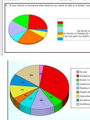

Is it possible to increase the tilt of the 3D Pie?

No, I meant the angle on the pie, see sample file, the top is what I am getting from Steema, the bottom one is what is required,

Sorry , I got confused. In your case you, first you must change Chart3D as do in next line of code:
    tChart1.Aspect.Chart3DPercent = 40;
If previous line of code doesn't solve your problem you can change the Orthogonal angle as do in next lines of code:
tChart1.Aspect.Orthogonal = true;
tChart1.Aspect.OrthoAngle = 30;
If you have any problems please let me know.

Have tried both of these ways and neither change the pie

Ok. Please check next code if works in your end?
 Steema.TeeChart.Chart tChart1;
    protected void Page_Load(object sender, EventArgs e)
        tChart1 = WebChart3.Chart;
        InitializeChart();
    private Steema.TeeChart.Styles.Pie pie1;
        pie1 = new Pie(tChart1);
        //tChart1.Aspect.Orthogonal = true; //uncomment if you want work with Orthogonal property.
        //tChart1.Aspect.OrthoAngle = 30;//uncomment if you want works with a Orthogonal property and a determinate angle
        pie1.FillSampleValues();

Work out why and the Chart3DPercent now works thanks
