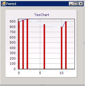

I have a need to not show the Barjoin line when data for that bar/point is null. Corresponding bar comes as blank but the barjoin line joins to the last drawn point. Here are the actual snapshot and the way I want. Please let me know if this is posssible.
My need.
Actual
