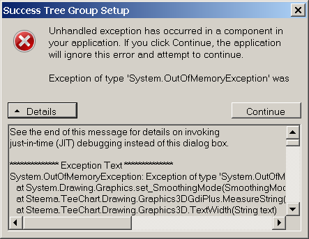

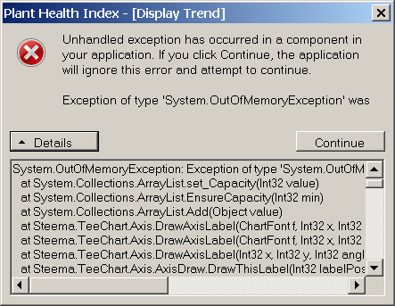

After we keep running our application till 8-10 days we arte getting out of memory Exception.(Snap is Attached.) When we start our application it takes 150-180 MB memory.But after 8-10 days it reached up to 1500 MB.

- OutofMemory.png (16.55 KiB) Viewed 3205 times
- Out Of Memory Exception
- Memory Leak Error.png (18.25 KiB) Viewed 3192 times
