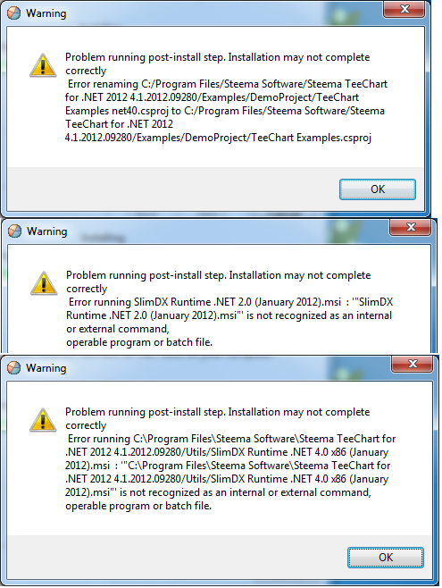

when I installed for the first time TeeChart for .NET 2012 4.1.2012.05100 (trying with different selection options) I had some installation errors, but I did not care about because component was working and I was able to develop my application.
The main problem I identified was related to demos not working.
Now I tried to update to latest version, hoping to a better result, but I had the same problem.
During installation setup I selected
- all frameworks
- VS2008 and VS2010
- Direct2D for VS2008 and VS2010
I had this errors during installation

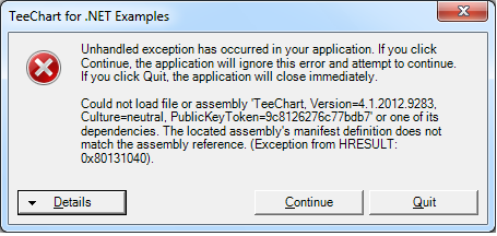

And I have this error running Feature Demo

We could reproduce the problem here now. For the demo try copying TeeChart.dll and TeeChart.Video.dll from C:\Program Files\Steema Software\Steema TeeChart for .NET 2012 4.1.2012.09280\net40\x86 to C:\Program Files\Steema Software\Steema TeeChart for .NET 2012 4.1.2012.09280\Examples\DemoProject\bin\ExecutableDemo and try running the demo again. The problem is that the assemblies there were .NET 3.5 and the *.exe was build with .NET 4.0. We will try to fix the issue here.
