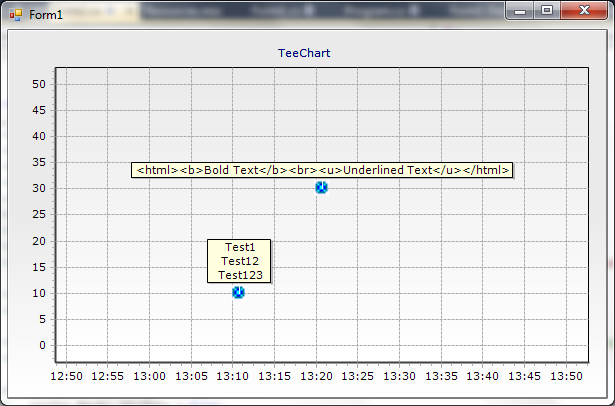

I'm facing issues when trying to format the Text displayed in the Series Marks.
series.Marks.TextAlign = StringAlignment.Near; should align the text in the series marks to left for my locale. But it always aligns it to center.
Also, I'm not sure how the series marks can be formatted with HTML tags.
series.Marks.TextFormat = Steema.TeeChart.Drawing.TextFormat.Html; is also not taking effect.
Here is the sample code:

Here is the screenshot:
Series Marks
Please advise me on this.

Post by Sandra » Fri Oct 26, 2012 3:15 pm
Hello Sugan,
I'm afraid that this feature is still not fully implemented and thus not working.I have added your request in wish list with number[TF02016393]. We will try to fix it for upcoming versions of TeeChartFor.Net.
