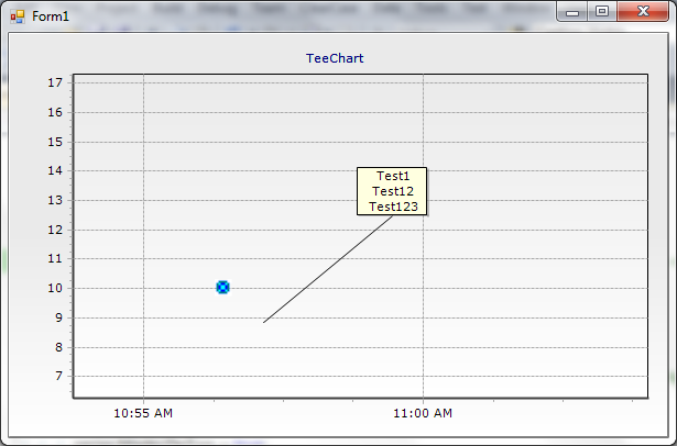

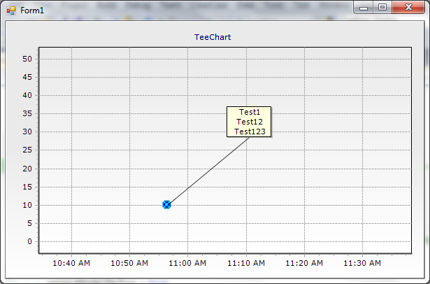

The DragMarks tool in TeeChart behaves wrongly when the chart is zoomed or panned. The connector line looks misplaced after zooming or panning the chart. This doesn't happen is the marks are not dragged.
Here is the screenshots of the same,
Before Zoom:

After Zoom:

Re: Issue with DragMarks tool
