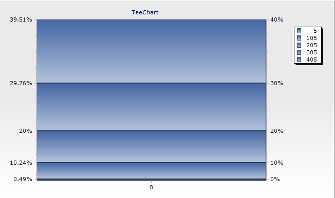

The result image I have gotten is next: .
Could you tell us which version of TeeChartFor.Net are you using? If you use the last version and the problem still appears for you, please send us a simple code because, we can reproduce issue here and try to find a solution for you.

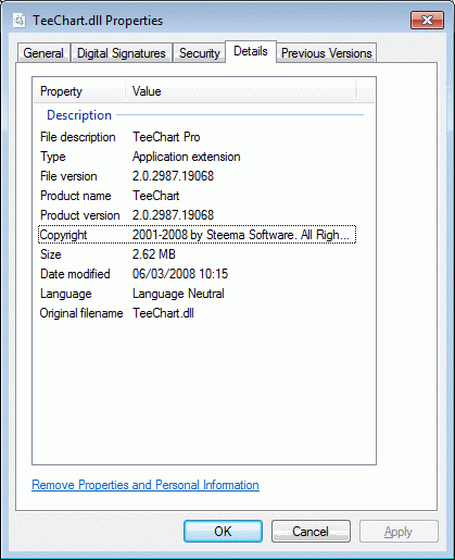

Hi Sandra,
Thanks for your quick response. The details of the TeeChart dll I'm using are...
TeeChart Dll Details.gif (26.77 KiB) Viewed 10378 times

Thanks for information. Basically, your problem is that BarWidht property doesn't work in correct way in version 2 and it breaks your application. If you want achieve the same results than latest version TeeChartFor.Net 2012 I recommend use CustomBarWidth property as I do in next code:
