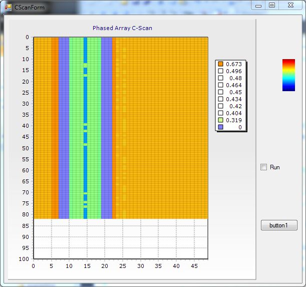

I have created a ColorGrid and I am using a 64 color custom Palette. The ColorGrid works perfectly with the assigned colors. The legend values are also showing correctly, however the color boxes next to the values are all White. Using the ChartEditor, I can switch to a built in Palette which changes the colors on the ColorGrid as well as the Legend colors.
Here is the code that I use to create the Palette.

I create the palette before any data is added to the chart. If I "Re-create" the palette after some data is added, I will get possibly 1 or 2 colors at the top and bottom end of the legend only with everything in between being white. I have attached a picture of my chart showing the problem

Hi Kev,
That probably means that all the values in your custom palette are white. If you look carefully at the values related to each color in the legend, you'll notice that those which are different from white are values that fall off the values in your palette levels. Please bear in mind that the Color parameter in AddPalette method will be used to fill polygons with Y values up to the Value parameter. Having this in mind and creating a simpler example you'll see how pointers are painted using custom palette colors:
If you can't get this working at your end please attach a simple example project we can run "as-is" to reproduce the problem here.
