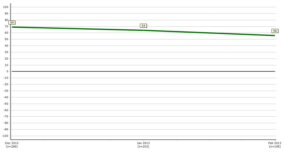

Have a line graph with a scale of -100 to 100, but require a line at 0, I have added a line but using value of 0, but this needs to be right next to the 0 on the Y-Axis with no gap, but still maintain the gap on the other lines.

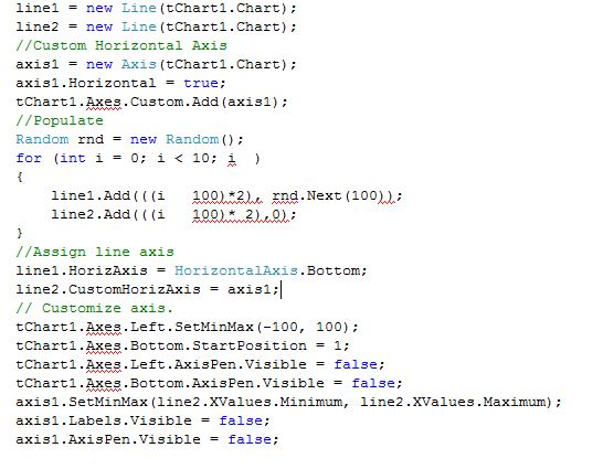

Thanks, does not like the following line
tChart1.Axes.Custom.Add(axis1);
Re: Line next to Y Axis
Post by Sandra » Mon Mar 18, 2013 3:07 pm
Hello mikethelad,
Sorry, but I don't understand what is the problem because the code works in correct way for me. Would be very grateful if you can tell us the exactly problem you have with line of code tChart1.Axes.Custom.Add(axis1);

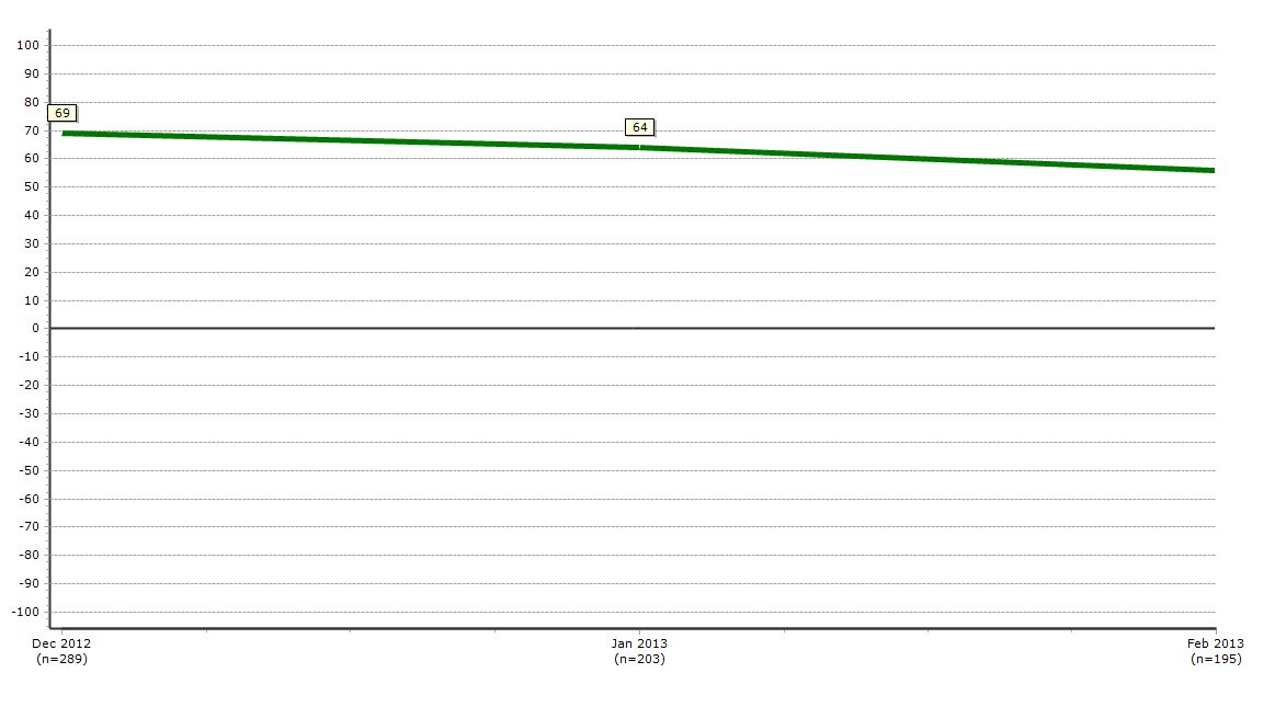

Great, works see new sample,
Can the X Axis be inline with -100 and not below?
Post by Sandra » Wed Mar 20, 2013 3:02 pm
Hello mikethelad,
I am afraid I can not reproduce your problem using last version of TeeChartFor.Net, could you tell us which version are you using? On the other hand, a solution for you is change the minimum offset of Left Axis, as do in next line of code:
WebChart1.Chart.Axes.Left.MinimumOffset = -1;
I hope will helps.
