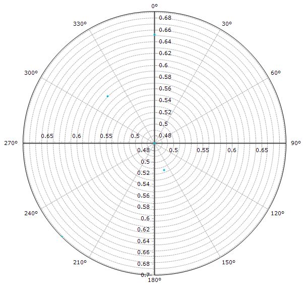

I have a PolarBar chart and it appears that the labels on the bottom axis aren't aligned with the corresponding "ring". in the attached picture, if you look at the 0.65 ring, it lines up with the left, top, and right labels, but not with the bottom.
we are using TChart version 4.1.2011.4193. is this a bug? if so, has it been corrected in a more recent release?
i have gotten around this by using the following code right after adding the series to the chart.
ISOCntrAngleChart.Axes.Left.SetMinMax(ISOCntrAngleChart[0].MinYValue(), ISOCntrAngleChart[0].MaxYValue());
ISOCntrAngleChart.Axes.Right.SetMinMax(ISOCntrAngleChart[0].MinYValue(), ISOCntrAngleChart[0].MaxYValue());
ISOCntrAngleChart.Axes.Top.SetMinMax(ISOCntrAngleChart[0].MinYValue(), ISOCntrAngleChart[0].MaxYValue());
ISOCntrAngleChart.Axes.Bottom.SetMinMax(ISOCntrAngleChart[0].MinYValue(), ISOCntrAngleChart[0].MaxYValue());

after a bunch of experimentation, it turns out that i only need to set the Min/Max of the Left and Bottom. Left uses Min/Max Y and Bottom uses Min/Max X.

Hello Pete,
Using next code in last version of TeeChartFor.Net, your problem doesn't appear:
Could you confirm us if your problem is solved using last version of TeeChartFor.Net?

Re: PolarBar bottom axis labels are misaligned.
Hi Sandra,
I'm glad to see that it doesn't happen in the version you are using. unfortunately, this chart is embedded in a number of custom controls that we have as part of our solution, and, to change them out might be a bit of a challenge, as i didn't write any of the controls.
i would imagine that simply having the comment in the thread that this appears to have been resolved in the latest .NET version, might make a future code seeker feel better at ease.
i'm not sure if it makes a difference, but the series we're adding to the chart is a PolarBar, not a plain "Polar" series.
below is the code ...
Steema.TeeChart.Styles.PolarBar PolarSeries = new Steema.TeeChart.Styles.PolarBar();
PolarSeries.Circled = true;
PolarSeries.Pen.Visible = false;
PolarSeries.Pointer.Pen.Color = Color.Aqua;
PolarSeries.Pointer.HorizSize = 2;
PolarSeries.Pointer.VertSize = 2;
PolarSeries.Pointer.Style = Steema.TeeChart.Styles.PointerStyles.Diamond;
PolarSeries.CircleLabels = true;
PolarSeries.CircleLabelsRotated = false;
PolarSeries.LabelsMargin = 1;
PolarSeries.RotationAngle = 90;
foreach (GantryBeamInfo rs in Results)
PolarSeries.Add(rs.BeamCalcAngle, rs.BeamDistance);
ISOCntrAngleChart.Series.Add(PolarSeries);
right after this is where i added the SetMinMax calls that correct the label behavior.
Hello Pete,
The same code using a PolarBar works in correct way using last version:
