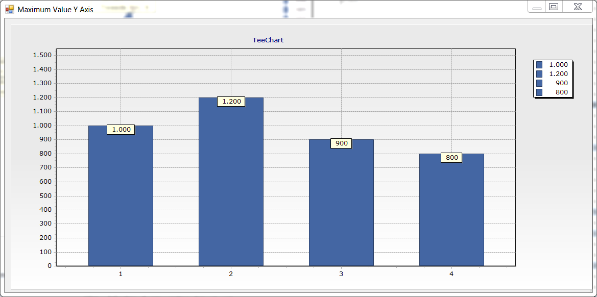

We have an issue when trying to set the maximum value for the left axis.
This is my code snippet:
chartToTest.Aspect.View3D = false;
chartToTest.Axes.Left.AutomaticMaximum = false;
chartToTest.Axes.Left.Maximum = 1400;
Steema.TeeChart.Styles.Bar bar = new Steema.TeeChart.Styles.Bar(chartToTest.Chart);
bar.MarksOnBar = true;
bar.Add(1, 1000);
bar.Add(2, 1200);
bar.Add(3, 900);
bar.Add(4, 800);
So, as you can see, I set the maximum value for the left axis to 1400.
But, if you take a look to the chart in the attached screenshot, you can see that the maximum is 1550.
What can I do to have the maximum set to 1400.
Thanks in advance,
Marijke Van Bergen
Re: Maximum value of Left Axis
Post by Sandra » Thu Apr 18, 2013 4:14 pm
Hello Marijke Van Bergen,
My recommendation is change the value of MaximumOffset if you want the axis left values are changed correctly. See next line of code:
 tChart1.Axes.Left.MaximumOffset = 1;
I hope will helps.

Hello Sandra,
Thanks for your suggestion, but unfortunately this does not help.
I added the MaximumOffset to my code, but chart still looks the same.
Kind regards,
Marijke
