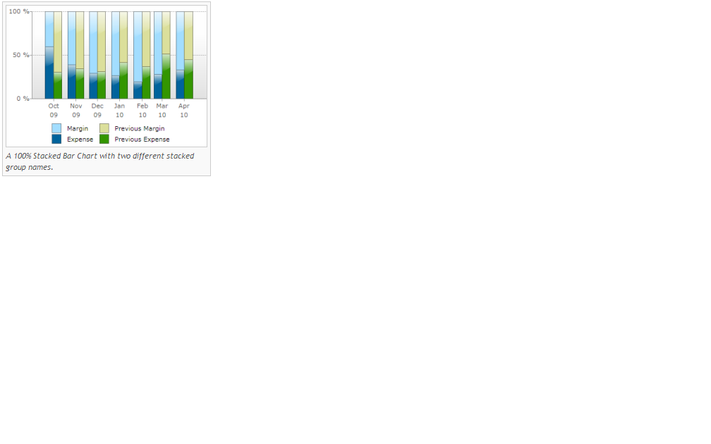

I have a need from a customer to produce a bar chart that totals up the passed/failed/undetermined status for daily shipments. In the past we have used a 100% stacked bar chart that has worked well. My customer wold not like to see three bars for each date, all using the 100% stacked method. How can I display three separate bars for each date.
For example the data may look like shown below for each day:
Day-------------------- Cat1Pass Cat1Fail Cat1Und Cat2Pass Cat2Fail Cat2Und Cat3Pass Cat3Fail Cat3Und
1 May 2013---------------------5----------3--------2----------8--------2----------3---------9----------2--------9
The chart needs to look similar to the image below, but with 3 bars.

I think you can do something as next code where I use a StackGroup property:
          Random rnd = new Random();
          for (int i = 0; i < 4; i++)
            Steema.TeeChart.Styles.Bar series1= new Steema.TeeChart.Styles.Bar(tChart1.Chart);
            series1.BarStyle = BarStyles.RectGradient;
            series1.Gradient.Direction = LinearGradientMode.Horizontal;
            if (i % 2 == 0)
              series1.StackGroup = 0;
              series1.MultiBar = MultiBars.Stacked;
              series1.StackGroup = 1;
            DateTime dt = DateTime.Now;
            for (int j = 0; j < 10; j++)
              series1.Add(dt, rnd.Next(100));
                dt = dt.AddDays(1);

Thanks for that. The StackGroup property did the trick. The only issue I had was that if NULL values were associated with any of the series, the stacks were added to the wrong group. I changed my data to use zeros instead on Null values, and it seems to work fine. Thanks for your help.
