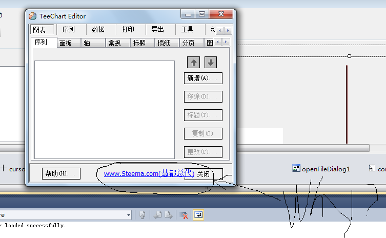

1.I have bought your product,why when design my software can still see like this

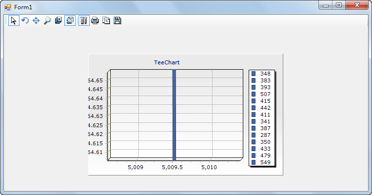

2.When the value of left axes change,and the number become like(20 to 20.152),the location of axes can not chang automatic.
It should like this
thank you very much!
Could you translate to English the message there is side the http://www.steema.com within the parenthesis, because we can try to discover because it appears?
2.When the value of left axes change,and the number become like(20 to 20.152),the location of axes can not change automatic.
I can not reproduce your problem using next code and latest version of TeeChartFor.Net:
      Steema.TeeChart.Styles.FastLine fast = new FastLine(tChart1.Chart);
      Random rnd = new Random();
      for (int i = 0; i < 10; i++)
        fast.Add(i, rnd.Next(10));
Could you please arrange a simple project for us because we can reproduce your problem?

hello,
1.That is a name of a company which is an Agents of you in china!
Because before I buy your product in your website, I download a Trial version of Teechart.NET on the agents's website.
Ok, thanks for information. Is possible you have a incorrect reference in your project or the latest version isn't installed correctly. To check it, please following my recommendations:
1.- Check if you use a correct TeeChart.dll in your project. To do it please following the steps:
- Open your project and go to Reference folder.
- Remove Teechart.dll
- Click with right button the Reference folder and add the latest TeeChart.dll. You find it in a similar path as next:
C:\Program Files\Steema Software\Steema TeeChart for .NET 2013 4.1.2013.05280
- Click with right button in the solution and choose clear solution.
- Click with right button in the solugion and choose rebuild project.
- Run your application and check that in Editor there isn't any text.
2.- You could taking a look in this thread to try to solve the problem:
On the other hand, could you tell us if you open editor in design time or in run time?
2.Before I uninstall the new version ,the chart work ok ,and I haven't exchange my code after I install the new version.So I think it's none of my code business,and when I use the chartcontroller to add a series with random data,the problem still exist!If you still need my code I can give to you!
Would be very grateful if you can send a simple code for us, to reproduce exactly your problem and try to find the problem.

About point 2:
Could you attached for me your data databx, databl1, because we can use your data to reproduce your problem?

1.It's in design time,if in runtime ,can not see it.
Do you do my suggestion of previous post, that consist in remove the TeeChart.dll of your project and if it doesn't work, check if you can installed correctly the TeeChartFor.Net?

hello,
I build a new applcation and use the random data,it is still like this.
And about my data ,may be I should email to you.
Re: After I install the new version,I met problems!
Post by Sandra » Thu Jun 27, 2013 1:41 pm
Hello mingyang_203,
Thanks for your information as explained previously I have reproduced the problem here.

hello,
I do your suggestion,but the problem still exist!I remove the teechart.dll and add the new one!
Post by Sandra » Thu Jul 04, 2013 3:52 pm
Hello mingyang_203,
Ok. We have decided to remove from the editor the label www.steema.com. Therefore, it will be fixed for next maintenance release.
Post by Sandra » Fri Jul 05, 2013 11:48 am
Hello mingyang_203,
Does it impact I distribute my software?
The impact are visible when new maintenance release are published. Anyway this change is cosmetic and doesn't effect to the correct behavior of TeeChartFor.Net. On the other hand, if you use the source code you can change the code while wait the new release. The changes I have made are in ChartEditor.cs class in next lines:
Method InitializeComponents:
        // linkLabel1
        this.linkLabel1.AutoSize = true;
        this.linkLabel1.FlatStyle = System.Windows.Forms.FlatStyle.Flat;
        this.linkLabel1.Font = new System.Drawing.Font("Tahoma", 9.75F, System.Drawing.FontStyle.Regular, System.Drawing.GraphicsUnit.Point, ((byte)(0)));
        this.linkLabel1.Location = new System.Drawing.Point(142, 10);
        this.linkLabel1.Name = "linkLabel1";
        this.linkLabel1.Size = new System.Drawing.Size(114, 16);
        this.linkLabel1.TabIndex = 1;
        this.linkLabel1.TabStop = true;
        this.linkLabel1.Text = "www.Steema.com";
        this.linkLabel1.UseMnemonic = false;
        //Is considered that linkLabel1 isn't necessary,therefore we have hidden the linkLabel. Modified by SP
        this.linkLabel1.Visible = false;
        this.linkLabel1.LinkClicked += new System.Windows.Forms.LinkLabelLinkClickedEventHandler(this.linkLabel1_LinkClicked);
Method Load_ChartEditor:
private void ChartEditor_Load(object sender, System.EventArgs e)
#if TEELITE && POCKET
      tabControl1.TabPages.Remove(tabTools);
      tabControl1.TabPages.Remove(tabExport);
      tabControl1.TabPages.Remove(tabPrint);
	  tabControl1.TabPages.Remove(tabThemes);
      tabControl1.SelectedTab=tabChart;
#endif
      Icon = EditorUtils.TChartIcon();
      //As LinkLabel1 isn't necessary, next lines aren't necessary. Modified by SP
     /* linkLabel1.Visible = (Chart != null) && (Chart.parent != null) && (Chart.parent.GetContainer() != null);
      if (linkLabel1.Visible)*/
        bHelp.Visible = true; //linkLabel1.Visible || (HelpFileName.Length!=0);
      if (LBGroups.Visible)
        FillGroups();
When can we use the next maintenance release?
I can not give you an estimate date but i recommend you to be aware at this forum, our RSS news feed, twitter and facebook accounts for new release announcements and what's implemented on them.
Post by Sandra » Tue Jul 16, 2013 10:23 am
Hello mingyang_203,
I inform you, after revise the bug number [TF02016623] we consider it isn't a bug,because this behavior is by design. If you want solve your problem you can do something as next code:
      InitializeChart();
    Steema.TeeChart.Styles.FastLine line1;
    Steema.TeeChart.Tools.ScrollPager scrollPager1;
      //Chart
      //Series
      line1 = new Steema.TeeChart.Styles.FastLine(tChart1.Chart);
        line1.Add(i, rnd.Next(10));
      scrollPager1 = new Steema.TeeChart.Tools.ScrollPager(tChart1.Chart);
      scrollPager1.Series = line1;
      tChart1.Legend.Visible = true;
      tChart1.Zoom.Direction = Steema.TeeChart.ZoomDirections.Both;
      tChart1.Chart.Panning.Allow = Steema.TeeChart.ScrollModes.None;
      tChart1.Chart.CustomChartRect = false;  //<-- use this
      tChart1.AfterDraw += tChart1_AfterDraw;
      tChart1.Panel.MarginUnits = Steema.TeeChart.PanelMarginUnits.Pixels;
      tChart1.Panel.MarginLeft =20;
      tChart1.Draw();
       tChart1.Panel.MarginBottom = scrollPager1.SubChartTChart.Top-110;
