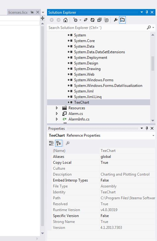

We already removed all known references to TeeChart.dll in Visual Studio,
and manually added the new one as reference from this path:
C:\Program Files\Steema Software\Steema TeeChart for .NET 2013 4.1.2013.07300\net45\x86
Enclosed screen dump 1 shows "TeeChart" in the "References" list in Visual Studio after we added the dll.
Is this correct?

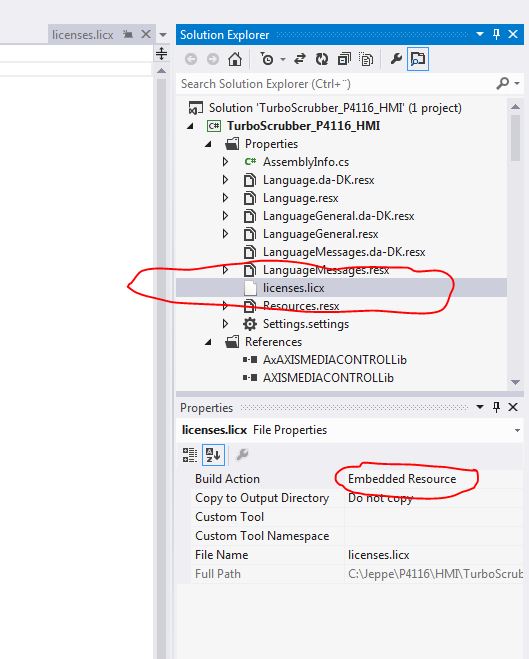

Enclosed screen dump 2 shows how licenses.licx is embedded, is this correct?
We have also tried to manually copy licenses.licx to the folder that contains our application on the customers PC,
but still no luck.
Is this correct?
but still no luck.

Are you deploying the application with licenses.licx compiled as an embedded resource and include TeeChart.dll? If the problem persists please send us the files being deployed and a test project, please. You can send your files to info at steema dot com.
Re: URGENT!! Application does not start after upgrading
See my previous posts above for this information.
Does it look right?
Does it look right?
Hi JohnS,
Yes. I'm sorry but, since this is very strange, I wanted to double check it. Could you please arrange a simple example project with a TeeChart component on it, check if it fails at your customer's and if that's the case send us the .exe and the project?See my previous posts above for this information.
Does it look right?
