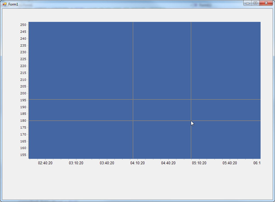

Look it this example of reproducing a bug in CursorTool when FastCursor = true:
Move the cursor in our previous program example so the cursor with cross hair is drawn.
Press ALT+TAB to show a different program in Windows.
While this different program is overlapping the TeeChart program move the mouse a bit.
Press ALT+TAB to show the TeeChart program again.
Now you should see that that old cross hair is still there, and the new one together with the mouse cursor.
The enclosed screen dump shows this at our PC.

Yes, you are right. I have added the defect to the bug list (TF02016707) so that CursorTool.FastCursor functionality is revised and fixed.JohnS wrote:Look it this example of reproducing a bug in CursorTool when FastCursor = true:
I'll also have a look at your example and see if its performance can be improved.
