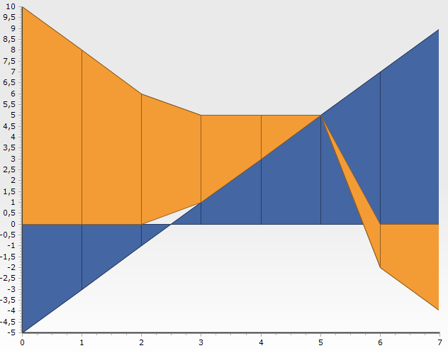

I have 2 area charts that are stacked and 1 of these charts has both positive and negative numbers and the other chart only has positive numbers. In this case some strange behaviour occurs (see image).

Is it possible to avoid this kind of behaviour and make sure that for instance there are no white spaces between the orange chart and the blue one (between x values 2 and 3)?

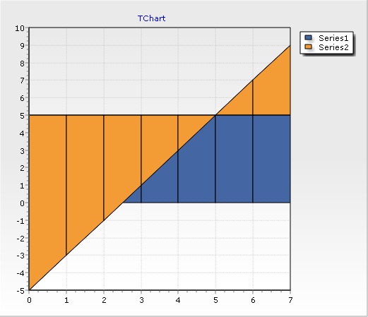

I could reproduce the problem here and added it to the bug list (TF02016717) to be fixed for future releases. I have also checked the VCL version doesn't reproduce this problem:
Is this the way you'd expect the chart to be rendered?
