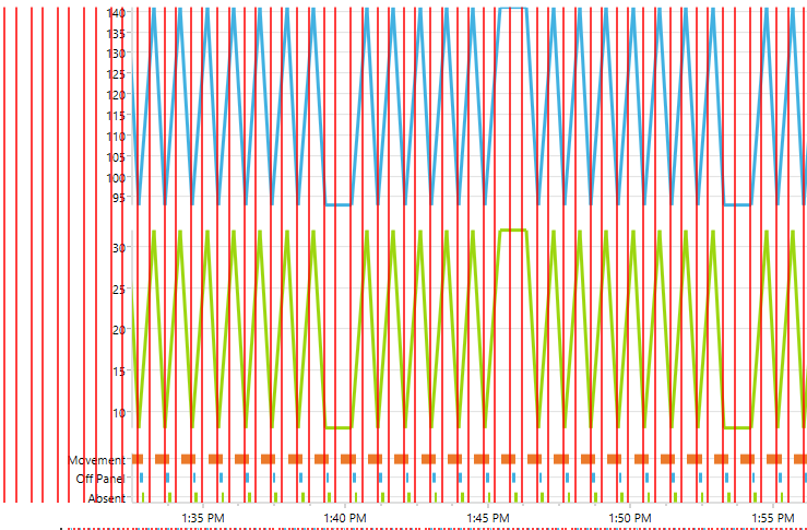

My WPF TeeChart has multiple ColorLines attached to the Bottom axis. Unfortunately, the lines that have values outside of the "series area" of my chart are still being drawn. In the image above, you can see the ColorLines drawing over my axis label area.
I'm adding the lines with code similar to the following:
            var line= new ColorLine( chart)
                Axis = chart.Axes.Bottom,
                Pen = { Style = DashStyles.Solid, Color = Colors.Red, Width = 1 },
                Value = Utils.DateTime(alarmEvent.Time),
                AllowDrag = false
Any suggestions for how I can eliminate this issue?

Post by Sandra » Wed Sep 18, 2013 11:56 am
Jeremy Johnson,
I recommend you two solutions for solve your problem in your code.
First, you can set ColorLine AllowDrag property to true as do in next lines of code:
  var line = new ColorLine(tChart1.Chart)
            Axis = tChart1.Axes.Bottom,
           Value = Utils.DateTime(DateTime.Now),
            AllowDrag = true
Previous code do that ColorLine isn't drawn out of bounds of chart.
Second, you can define a limit for the ColorLines aren't drawn out of bounds of Chart.
        public MainWindow()
            InitializeChart();
          FastLine fastLine1 = new FastLine(tChart1.Chart);
            AllowDrag = false
          tChart1.Header.Font.Bold = true;
          tChart1.Header.Font.Size = 15;
          fastLine1.FillSampleValues();
          fastLine1.LinePen.Width = 1;
          tChart1.AfterDraw += tChart1_AfterDraw;
        void tChart1_AfterDraw(object sender, Graphics3D g)
          for (int i = 0; i < tChart1.Tools.Count; i++)
            Steema.TeeChart.WPF.Tools.Tool tool = tChart1.Tools[i];
            if (tool is Steema.TeeChart.WPF.Tools.ColorLine)
              if ((tool as Steema.TeeChart.WPF.Tools.ColorLine).Value < tChart1.Axes.Bottom.Minimum || (tool as Steema.TeeChart.WPF.Tools.ColorLine).Value > tChart1.Axes.Bottom.Maximum)
                tool.Active = false;
                tool.Active = true;
Could you tell us if my suggestions help you to solve the problem?
I hope will helps.
