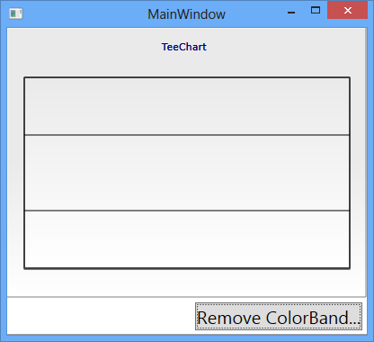

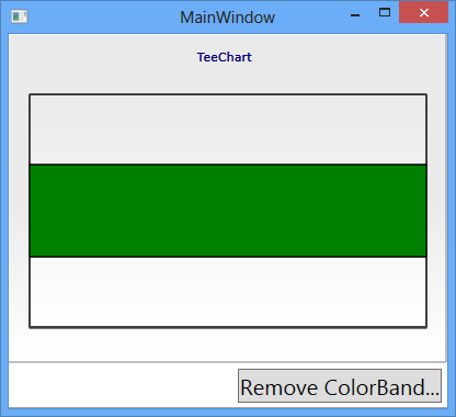

If I add ColorBand to TChart, then remove it, some dirt stays on the screen.
With ColorBand
After ColorBand removing
