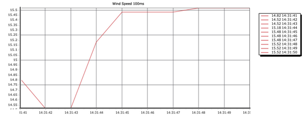

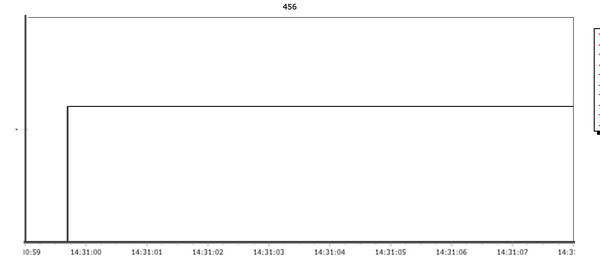

Steema.Teechart.Series.Line looks bad in View3d =false mode (especially on retina displays), while in 3d mode looks fine.
A) Density is very low.
B) Part of outside labels on axes are hidden
C) Strange chart look when value is constant
How to solve this problem?

Hello Thomas,
Many thanks for your information. I have added your problem in bug list report with number [TM71016739 ]. We will try to fix it to upcoming versions of TeeChart Xamarin for IOS. On the other hand, at the moment as a workaround, you can set the ZoomSrollStyle as Manual as do in next line of code:
chart3.Chart.Aspect.ZoomScrollStyle = Steema.TeeChart.Drawing.Aspect.ZoomScrollStyles.Manual;
I hope will helps.

Thanks. Suggested workaround works perfect
